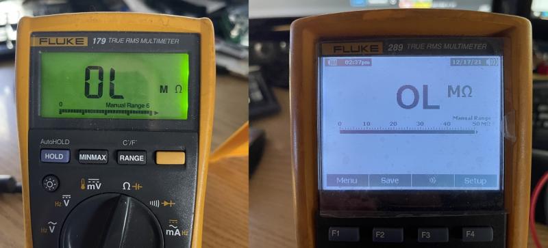

    ...a digital one will tell you if it is good full open or closed, it won't tell you if there are dead spots in between, with an analog, you can watch the needle sweep as you turn the throttle, if there are any hiccups on the way, the sensor is bad, if it's a smooth sweep, it's good.
    ...that can't be detected with a digital meter
    Any decent DMM will update its measurements fast enough for you to detect dead spots in a POT/variable resistor. Some even have analog bar graphs that update even faster than the digits themselves making it even easier to see what's going on.
    Multi meter-meter_displays-jpg
