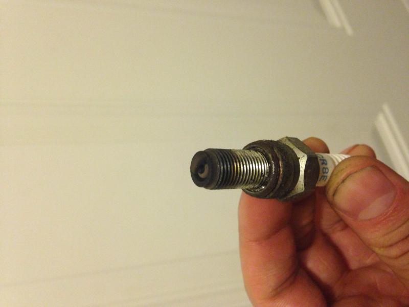

    Also, what do y'all make of this spark plug?
    piston & valves-img_1477-jpg

    The black on the piston and spark plug indicate that it was running very rich. It was getting too much fuel in the mixture. The valves look ok, but the pebbles on the piston look like flakes of metal. Have to figure out where those metal flakes came from. How does the cylinder wall look? If the piston crown looks like that I can only assume that the cylinder wall has also taken a beating.
    The rich mixture would not cause any engine problems. It would only cause the carbon buildup that makes the parts black. If the bike was running rich it would actually help to keep the piston crown temps down. Is the bike fi or carbed? Bringing it to a dyno and tuning it will make it run better for sure after the motor is fixed.

    The head and piston do not look too rich to me, and the carbon build-up looks pretty typical, IMO. Shiny would be very bad unless the engine was brand new or you just ran a bunch of water through it to steam clean it. What color is the inside of the header where it attaches to the head? Black is good there.
    Impossible to read the plug correctly since we don't know what you were doing just prior to pulling it and the important part to read on a race engine (I'm making an assumption here that this is a race engine based on your avatar) is way up inside. That said, it does not look to me like there's anything overtly wrong with mixture, heat range or timing. Really need a close up to know for sure though.

    The valves look ok to me too. My only concern would be the carbon build up, it looks shiny in the picture. That plus how clean the very outside of the piston is. If the rings were loosing bit of oil it would build the carbon(shiny carbon, normal carbon is more matte looking) in the center and clean the outside of piston like that. To really tell if the piston is ok you need to look at the skirt. I had an engine where the cylinder wall looked nice but that one cylinder burn a shit ton of oil and I mean james bond smoke screen amounts of oil. I'd have someone look at it in person for you pictures can be hard. Did it ever use oil or smoke?

    All looks AOK to me as well. FYI, you can't "read" the colors of a 4 stroke with any sort of reliability. They operate at a much wider range than a 2 stroke, so the carbon is meaningless, unless it's WHITE. Then you're fucked.
