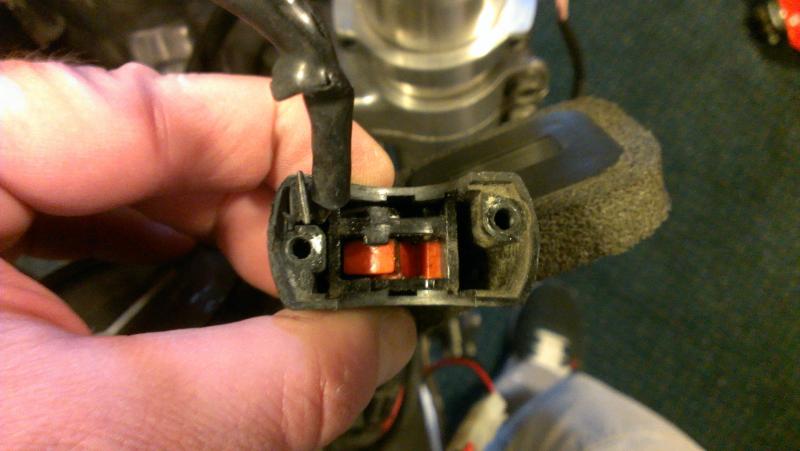

    The RS250 is almost ready for a track day - engine refreshed (thanks Chuck!), tires, etc - and I'm trying to start it up and put a few heat cycles into it. No luck so far, hoping some of the NESR gurus might be able to help....
    Bike is a 93 RS250, I'm running the recommended fuel-oil mix and following the starting instructions in the manual. The fuel is a couple years old but had been stored in a sealed container and VP claims its good for several years. Turning the motor with a starter tool/nut and a cordless drill. Didn't hear any sort of partial combustion in either cylinder so I pulled both plugs, can't see spark in either. Looked at the connections from the Run/Off handlebar switch to each cylinder, nothing obviously wrong.
    Before I start throwing parts at it - could both plugs be bad? They looked ugly - lots of carbon. The motor hasn't run in a couple years. The handlebar switch looks pretty rough (photo below) when I put a multimeter to it, what should I be looking for?
    Info and advice greatly appreciated

    Find a wiring diagram, that'll tell you if the switch is on for run or off for run. Then you can check it with a multi-meter.
    Spring for new plugs, and if it's sat for a long time new plug caps too.

    If you hook a multimeter up use the ohms setting and there should be continuity one way and an open circuit with the switch the other way, that will atleast tell you if the switch is functional or not.
    All the 2 strokes I've rebuilt sucked to get started the 1st time but they were also all kick start. I literally kicked until my leg about fell off without a slightest pop but there would always be some smoke out of the silencer until they would sputter a few times, then eventually they all came to life. Are you getting any smoke out of it, fresh plugs definitely won't hurt any either.

    Thanks guys - I've ordered new plugs, caps and kill switch from RS cycles. While I'm waiting for those I'll test the old switch for continuity in the RUN and OFF positions.

    On the kill switch if it is one wire then that wire would just ground out the ignition right to the bar and killed the ignition.. And if it is a two wire like my TZ then one wire ran down to the frame and grounded out the ignition killing the engine. On the TZ the spark plug caps were problematic and I always kept a spare set and always kept newish ones on the bike. Install the spark plug caps with that dioelectric grease stuff. You can by a pack for a buck at Advance Auto.
