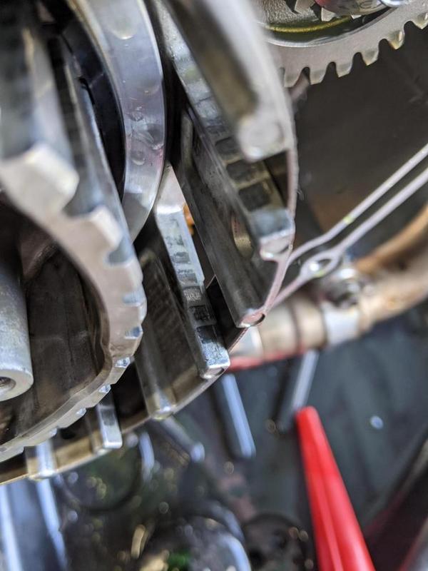

    Update time. number9 I think you were on to something. The basket and the carrier both are a bit grooved, see pictures. I'm guessing its time to replace these? Or is this normal wear? I put the whole thing back together with new plates, fibers, and spacer washers (before realizing that the grooves were indeed there) and had the same symptoms...took it back apart, and well here we are. Any thoughts by people smarter than I am on this subject?
    SV650 Clutch issue-h8ecowm-jpg
    SV650 Clutch issue-qjlt36m-jpg
    15,021
    Re: SV650 Clutch issue
    That's normal and not the cause of the issue. It is most certainly out of adjustment at the plunger.
