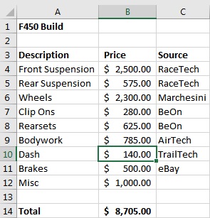

    Anyhow...this whole 450GP has had my interest for a while now, and I'm at a point financially now where I could start gathering parts and put the build together next year. I find myself fairly convinced in the RaceTech theory, which is to say that a sport bike front end is far too short for the application. See spreadsheet:
    771 Racing - Brain Download-f450-jpg
    There is some money to be saved if you choose. You could find a used set of wheels or go with a set of spoked Warp 9's instead of going for the Marchesini's and save at least $1,000. The rearsets from BeOn are a bit pricey, but I could purchase those and have my machinist replicate them for probably half the price for spares. Clip-ons are cheap through BeOn and again easily replicated, also Woodcraft and the like would have options as well. Would love to have the BeOn bodywork, but it's pricey at $1,600 (includes all hardware/stays) not to mention if you break it beyond repair you're ordering replacements from Spain. Looks like the TZ-P bodywork option is the least expensive and easiest to source. I budgeted $1,000 for misc items which may be on the steep side but would cover having rearsets duplicated. Anyhow, it's not a cheap project anyway you slice it. The complete RaceTech forks are pricey at $2,500, but it's a complete package for the front end save any 108mm caliper from eBay.
    I know Kurlon is going in a bit of a different direction with his build, the GPTech method looks to be around half the price. This is just me spit-balling.
