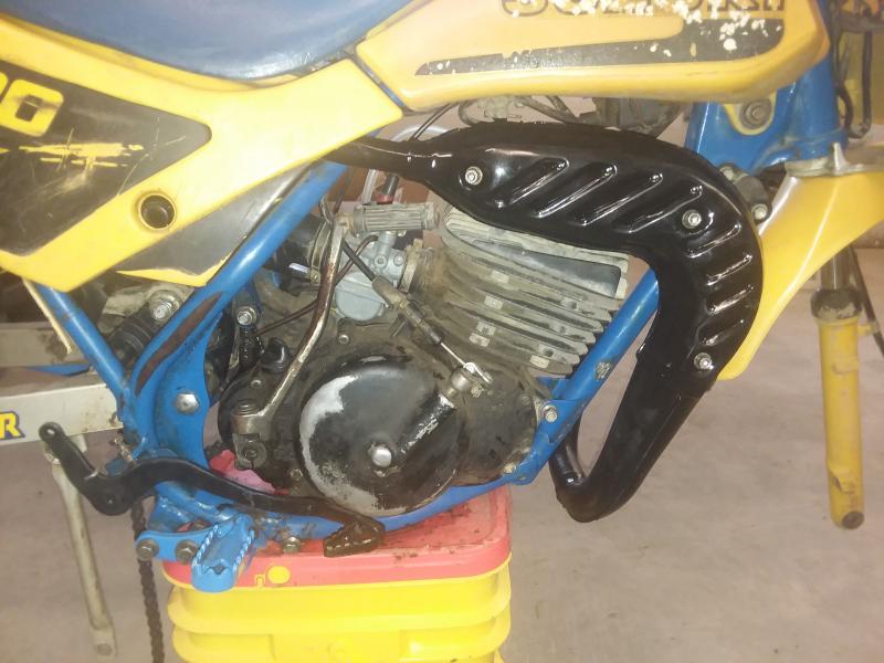

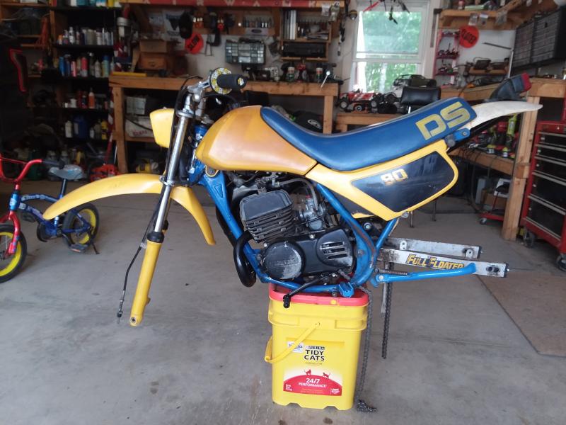

All cleaned up, carb cleaned, motor back in, wiring done.
Attachment 52764
Wire wheeled the rusty exhaust and hit it with bbq paint and new stainless hardware (had to drill one of the heat shield bolts out).

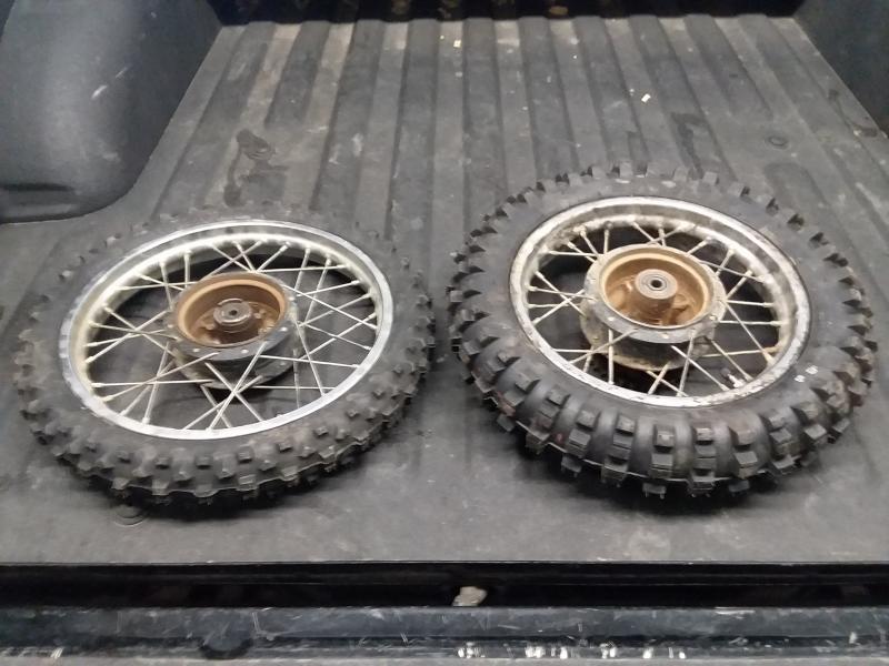

Got a call today that the new tires are mounted on the wheels. Throttle tube from ebay should be here Thursday or Friday, install brakes, throttle tube, grip, wheels and tires, change out the motor oil, and ill be kicking it over this weeknd!
Picked up the tires today!!!! Got home and see they have the front on backwards :(
Its a scorpion tire. it looks mostly symmetrical.
Im sure I can get it swapped back but it will take an hour round trip drive :confused:

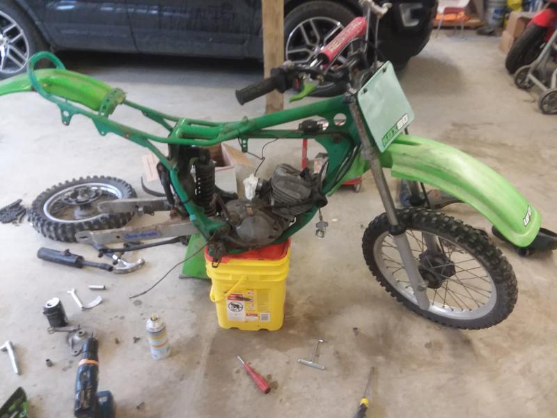

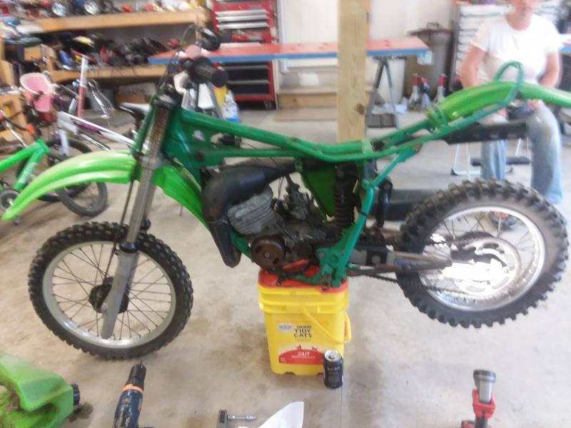

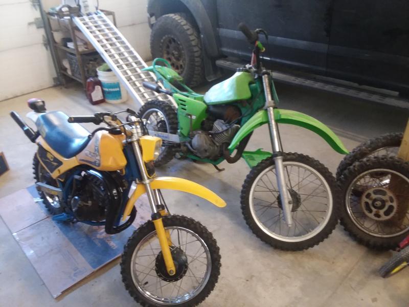

Someone help! They are multiplying!
Attachment 52777
First, I am quite surprised how much BIGGER the KDX80 is than the DS80.
Second, I can't believe how much harder it is to find parts for the KDX!
I have about $220 in parts on the way.

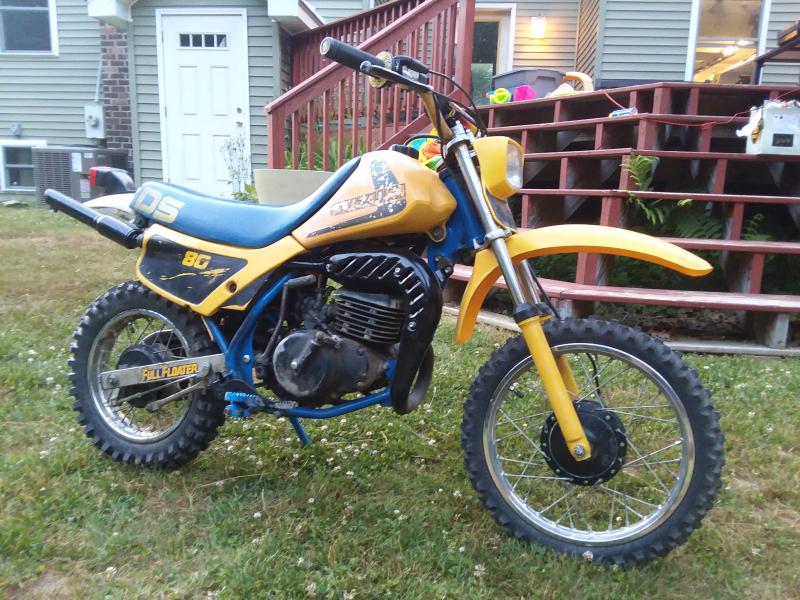

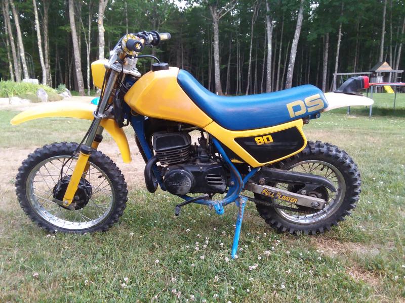

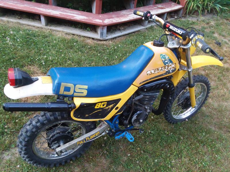

Finally done and got to ride it. Runs great! Its a fun little bike and came out pretty nice.
Not that I plan on selling it, but any idea what it is worth?

sweet! nice work ... hmm on price, not sure but i know you can get more if you find the original silencer, which is a little longer.

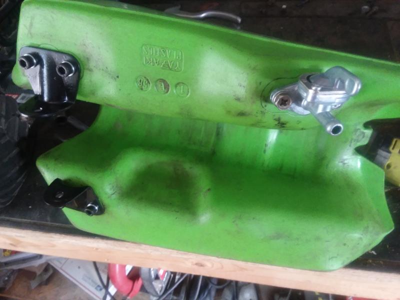

$54 new petcock made from unobtainium

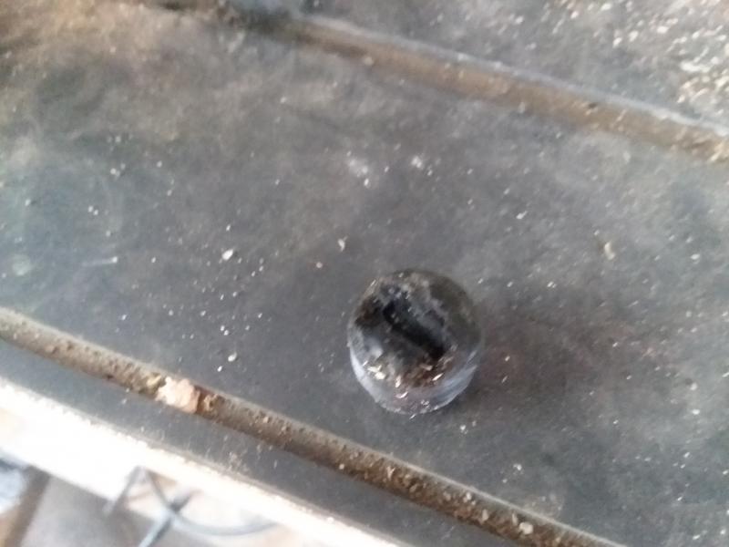

Oil cap was chewed by a mouse I think. Heated a flathead with a torch and melted it in, got a new cap for like $10

regarding the unobtanium petcock ... a refreshed petcock for the Champ is ... FIVE HUNDRED AND TWENTY FIVE DOLLARS :lol:
Goodbye lawn
yup, most complicated motorbike i've ever worked on which = very rare tiny bits all over it. pretty sure i got pissed at the OEM petcock and tossed it. wish i kept it, i'd sell it to the guy refurb-ing them. he'll do a $150 core if you supply a shit one when purchasing new. it's the delicate diaphragms that boost the price, it's vacuum assist ... gravity feed for this guy. fuck that noise.
