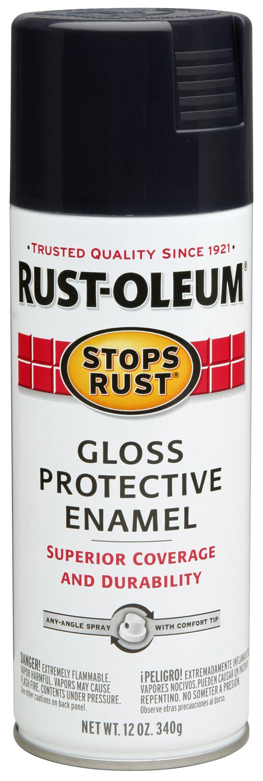

    But there is some chipping on the bottom. I'm not really worried about it cosmetically, I am more worried about it rusting. Any way to repair this without painting the whole tank?
    I'm thinking find some Rustoleum that's a close match and carefully painting it on?
    Get some automotive pinstriping tape to mask off the border, it is really good about working around contours and bends. Then back mask from there and blast it. You can probably get this color in a rattle can if you have the paint code.
    based on a couple tanks I've had in similar condition, I'd cream the inside of the tank, and paint the vertical seam with POR15 before covering with matching color
    Why would you want to guarantee tank problems down the line by ruining it with Kream? That crap is useless and when it fails is a mess to get rid of.
