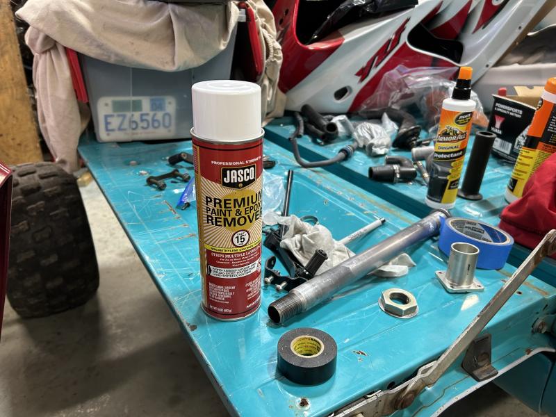

    Goof off, simple green, etc, didn’t touch the paint. I picked up this spray on paint/epoxy remover, and it worked amazing. It not only removed the paint, it didn’t damage the perfect clear coat/powder coat on the original parts.
    Bad decisions were made today..-img_6550-jpg
    I was surprised the all the parts I cleaned today, appeared to be in perfect condition.
    Bad decisions were made today..-img_6545-jpg
    Also removed the rear wheel so I could remove the paint from the chain adjusters… there aren’t even any sand chips in the swingarm from the rear wheel. Just confirms the low miles on this thing.

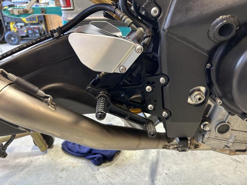

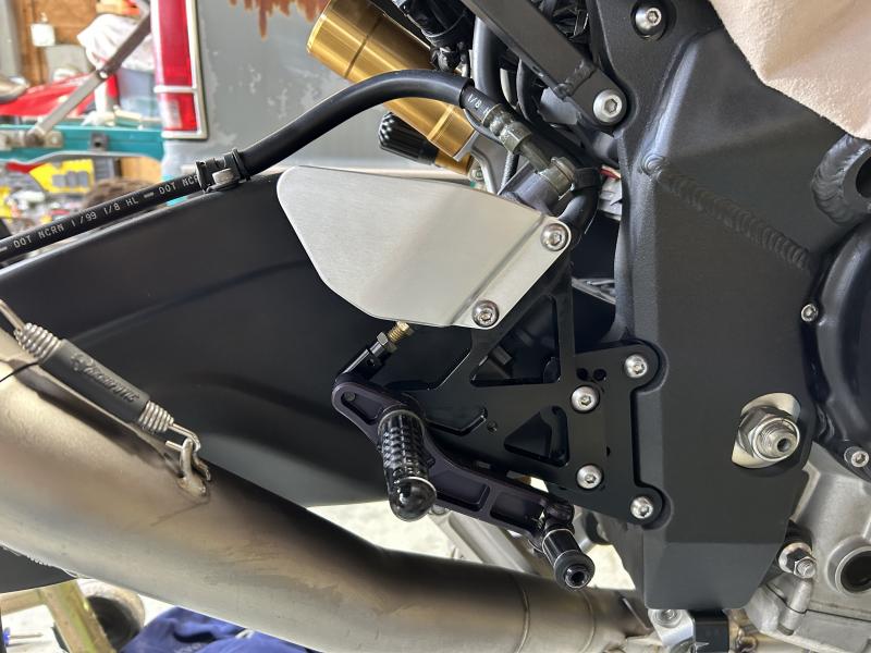

    Next, I wanted to put the original levers back on the rear sets. I took both rear sets apart, cleaned everything, greased the pivot points, installed the rear brake light switch, and was able to find the missing shift rod ends. Both rear sets are now functional in the same way they came from the factory.
    Bad decisions were made today..-img_6563-jpg
    Bad decisions were made today..-img_6562-jpg
