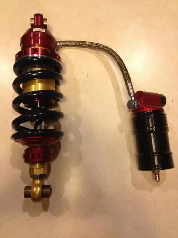

Ummm. Happy Birthday to me?
Attachment 35092
:mope:
I feel a little guilty. I should have told you to run. It's too late now... But anyway that looks sweet!
Yea, I'm pretty much beyond hope at this point.
Don't listen to this guy. He was warned.
I have to say, the Elkas are way more blingy than most everything else out there. Except maybe the Ohlins stuff.
This is one of those "scarily good" fleabay deals. We'll see how good it actually is if I ever receive it :).
For serious though: Happy birthday! Hope to see you trackside with that rolling banana before the year is over.

Wifey got me a gift certificate. :beerbang:
