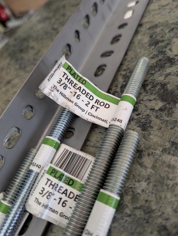

    Grabbed some perfed angle iron, some threaded rod, vinyl tubing and rounded up some odds & ends...

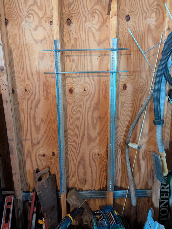

    Tacked it up and dry fitted to figure out where I'd like it, which holes to use, how to space them, etc...
    Detachables Storage Rack-pxl_20250427_203001978-jpgDetachables Storage Rack-pxl_20250427_211103312-jpg
    Simple assembly attached to studs in the garage...

    I still gotta pick up a few bits of hardware to finish it up. If you look at the pic with just the four rods mounted, you can see I'm missing nuts on the inside of the rack on the top two threaded rods. Those are more crucial than I originally thought as it helps prevent the angle iron from bowing or flexing when snugging down the outside mounting nuts. Without those inside "lock nuts" I can't snug up those top two as much as I'd like.
    I may also look into something with more of an outside diameter to go over the rods. There's a bit of play when items are mounted on 'em, but I'm not sure if that'll make it more difficult to get things on & off. I'm almost thinking copper pipe that will fit over the vinyl tubing just to snug up the accessories while they're mounted. I'm still trying to sort that out in the roadmap of a brain I have.
