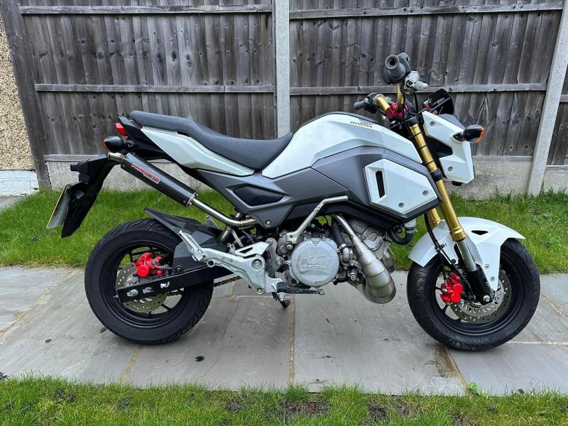

I'm tempted to pick this 250 Grom up: https://advrider.com/f/threads/honda...-2015.1761869/
Wow, crazy clean build.
