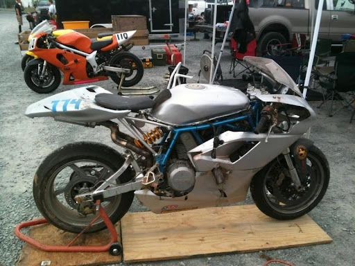

heres a pic of the bike post crash.. to be honest, what was made to absorb the impact did just that.. the axle jax frame sliders did what they were supposed to do.. the woodcraft clip ons spun some. the aluminum subframe absorbed some.. truth be.... absolute minimal damage. even all the bodywork survived. more pics to come.. and :naughty:naughty:beerbang::shredder:this just gives me the excuse to re-do the entire bike...:naughty:naughty:beerbang::beerbang::shredder::shredder:

hell!!!! if someone knows how to flip the pic please do
I'd try turning the camera over... ;)
funny thing is it shows rightside up on camera..
thanks for the flip

I was very impressed with how it survived that crash. The bike has less damage than you. Oh wait you looked like that before the wreck, only difference is the sling!
Things I found to be fixed:
Front fairing stay (Bend/weld touch ups & added structural strength)
Sub Frame (Bend/weld touch ups & added structural strength)
Replace/ bend clip on unbolt reposition clip on housing
Replace bar end/
Replace Throttle, & Throttle cable
Replace Brake Res, Brake lever (Possibly the entire brake assembly)
Replace (Obviously!) Front brake lines
Reposition rearset (Possibly replace Foot peg)
Reposition Frame slider after moving the location back in place
New tank clamp contraption!
Unmount, clean and remount tires removing all the dirt and grass!
Add a full fender or a bracket to keep lines from ever making contact with the tire again!
New paint job because you want too!
Did I miss anything?
