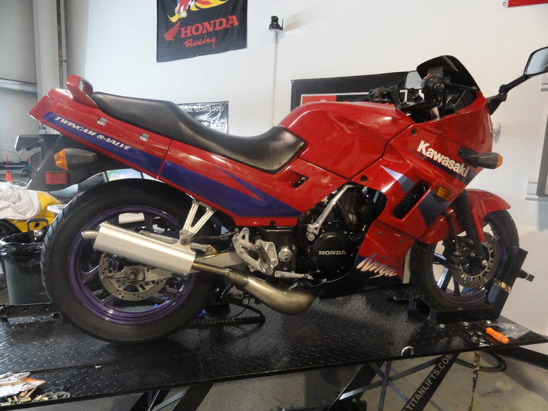

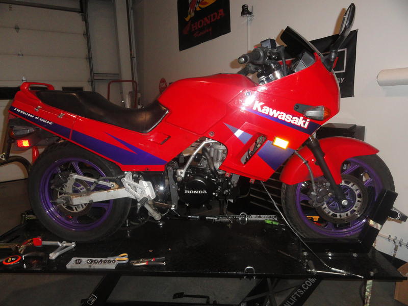

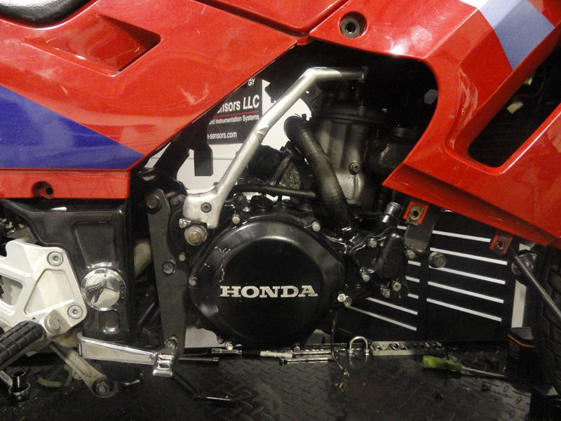

well, i put the cr250 motor in place..everything looks good to go. Fabed the motor mounts up. I should have it bolted in tommorrow if all goes well..Dam, this bike is going to be light! Ill post up some pics
3 Attachment(s)
Re: Ninja 250 motor transplant... what motor to use?
Attachment 37073
Attachment 37074
Attachment 37075
working on the pipe now...I keep pulling parts off..getting lighter and lighter.. to funny...

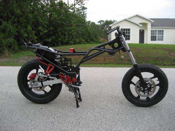

1 Attachment(s)

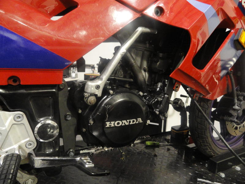

There's a big piece of structure missing between the steering head and the swingarm pivot.
Attachment 37076
I don't think this frame was meant to work without the engine, or some other structure, tying the bottom of the steering head to the swingarm pivot. Without that, the stress on the remaining frame is excessive. I think you need a pair of tubes under the engine.
Yup, there will be a cradle under the engine going up to the top. For testing, this will be just fine ;) This is the basic test bike... mostly dyno time not alot of street riding. Once we feel this works well, we will buy a 2010 modern 250.... new body style....

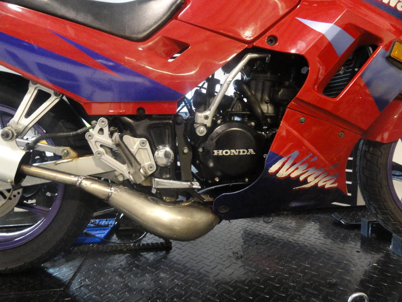

Got the pipe all done, motor mounted... finishing up the coolant hoses. chain, throttle etc... its fitting all real nice! Lets hope the vibration is to not excessive. Top speed looks to be about 90mph.... but it should get there quick! The bike weight right now is 275lb and with 45hp....should go just fine ;)
stay tuned!
Attachment 37158
Attachment 37159

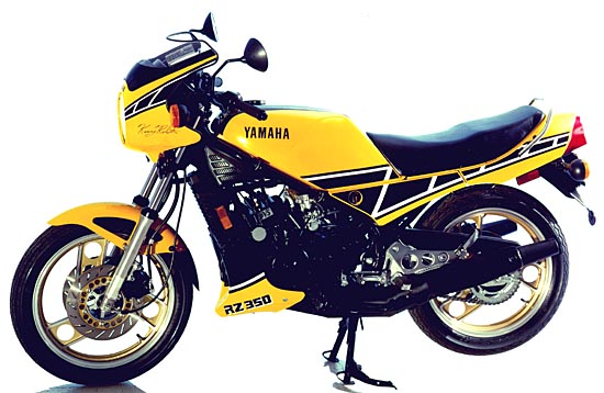

The Banshee motor has been done before.... by Yamaha. The RZ350
Attachment 37173

Is ground clearance on right-hand turns going to be an issue? From the pic it looks like it might
