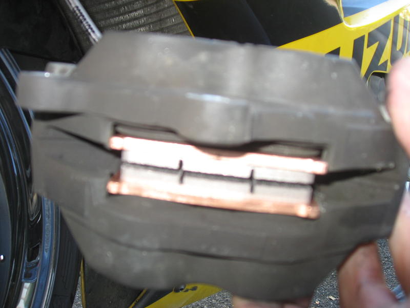

install the new pads, and put the pin back in the caliper to hold the pads. if you used your front brakes before taking the caliper out, your pads will probably look close together like this.

very carefully, get a flat head screwdriver between the pads and pry them apart. this will make it easy to get the caliper back on the rotor.
Attachment 29805

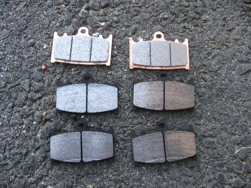

here's the view of the old & new pads
Attachment 29806 Attachment 29807 Attachment 29808

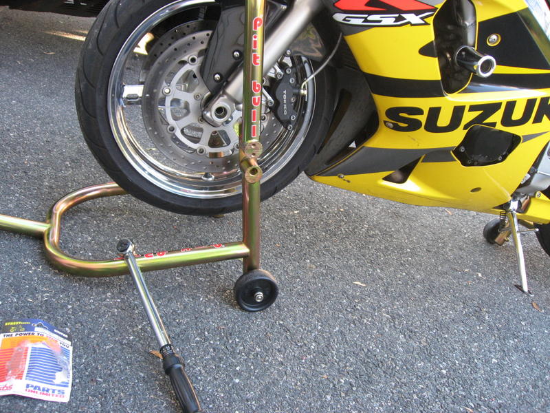

put the 2 caliper bolts back in with a 12mm socket and torque them to 18.1 ft/lbs (this one's for you garage guy)
Attachment 29809
the old stock Tokico pads
Attachment 29810

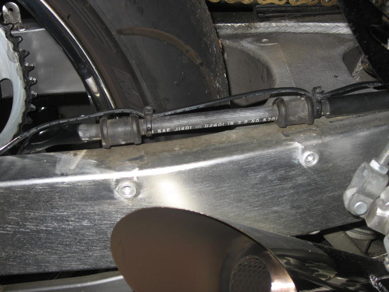

Remove the brackets holding the line to the swingarm with an 8mm socket & take the top cover off the rear brake reservoir.
Attachment 29811

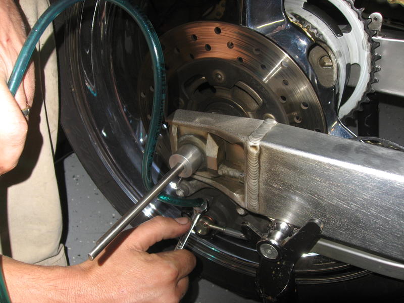

After loosening the bolt on the caliper with a 12mm socket, drain the old brake fluid into a pan & pump the rear brake.
Attachment 29812

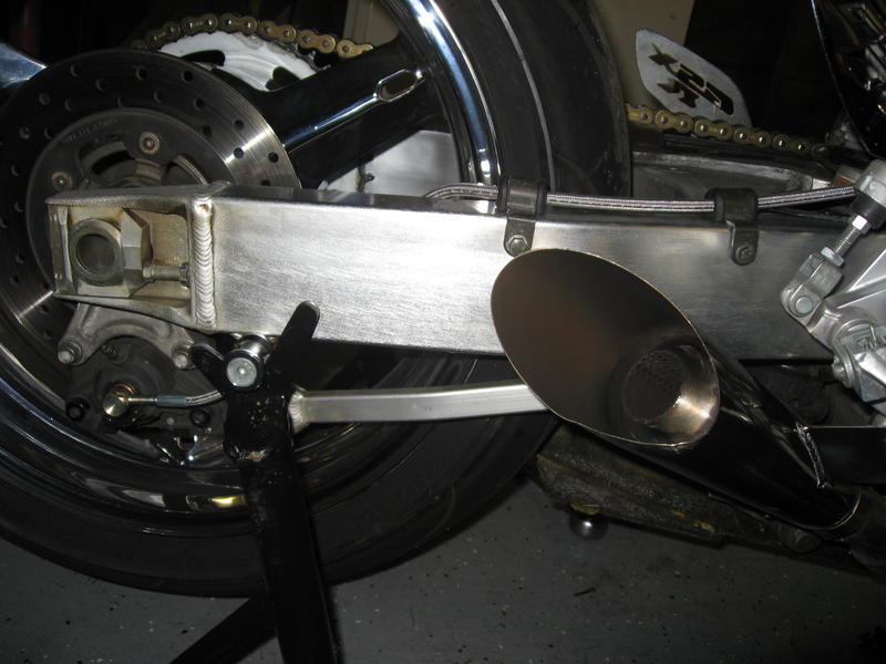

Reuse the rubber grommets from the OEM brake lines & install them on the new lines. Install the brackets that hold the lines to the swingarm.
Attachment 29812 Attachment 29813

just FYI but I would recommend pushing the caliper pistons back out without the pads in. Like you said its fine if you are very careful pushing on the new pads but its a good idea to push them out with the old junk pads in or without pads at all.
got one better for you - if you can let the pads sandwich together and sit on one side of pistons, then you can pry from the backside of the pads - at least thats what i can do on my 636 - then no chunks taken out of your pads

One of the important things if you ask me is to use a toothbrush and brake cleaner to clean the shit out of the caliper pistons before you push them back in. All that grime on the pistons isn't good for the piston seals/orings.
You can use emory paper, alternately.

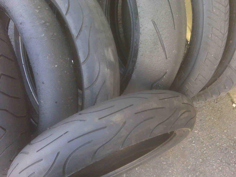

last update for this thread. my bike is now ready for that 225 mile ride in NH i''m doing next weekend. Got my new A* boots and SPIDI Penta gloves, and now it's time for a new(er) tire. My front tire was done, so swapped it out for another one with better tread.
Old vs New - Michelin Pilot Power 120 tire (non 2CT)
Attachment 29815
