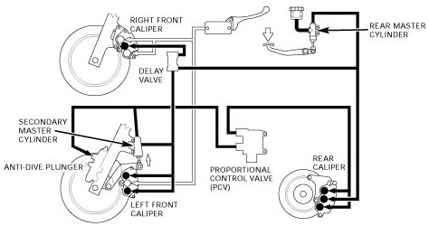

I understand how the backbleed works now on that type of bike, but what about something with dual front brakes? In the video he sort of touches on the subject, but doesn't show how it's done. Is it basically the same method?

I imagine you start with the longest leg, probably the left side caliper. Then repeat on the other side. Depending on where the junction in the lines is you may end up pushing a lot of fluid to do a full swap. My situation is even worse as the Y is right before the calipers but way after the ABS pump and miles of hard lines going to-from it.
Try it with this...
Attachment 38576
Any advice for 'reverse' bleeding a system with ABS and the bunch of plumbing that comes with it?
I'm thinking speed bleeders may still be a better bet for my setup as I can push the old fluid out of each caliper without having to flush the rest of the system twice.
For the non-ABS and non-linked brake bikes that seems like the ticket though.
So basically, I'm pushing Air/fluid out of the front left caliper first, towards the split that is in the right caliper (at least on my bike), and then up to the master? If there's air in the right caliper, will that get bled out in this process, and if it's not, what's to stop that air from going back through the split into the left caliper once I start bleeding the right side?
