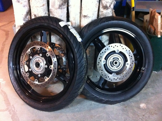

Changed my first ever set of tires last night. It went well.. mostly. I wish I could report it was way easier than I expected. It wasn't.

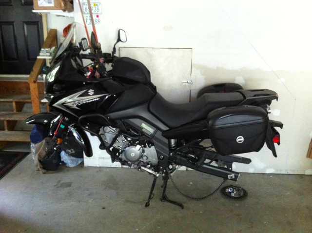

I had fun posting this on FB with the caption "low crime area my ass". Several of my friends thought I was fer serious. I got one frantic sounding email from my cruiser riding buddy asking how that happened.

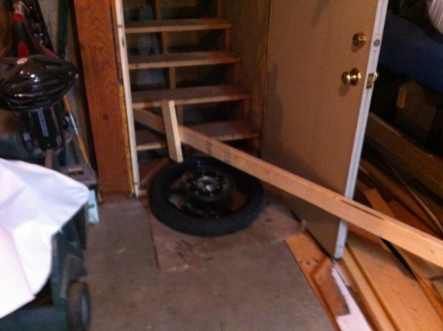

Bead breaker. That's some scrap 2x4 sheet-rock screwed together wedged under the stairs to my basement walk-out. I know class, yo.

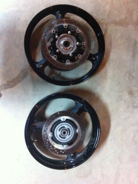

Everything came off pretty easy. The rear was a little stubborn, but I made it happen. I did scratch the rear a tincy bit in one spot. Like I say, more of those protectors woulda helped.

The front practically jumped onto the wheel, zero issues, I almost didn't need irons. I think the 19" wheel on my 'strom makes it easier.

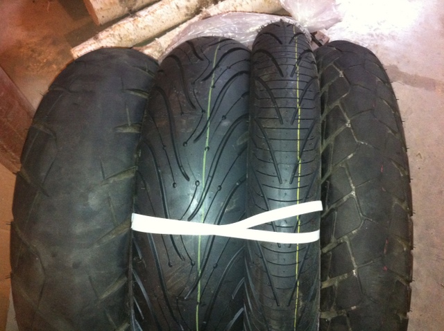

Mounting the rear was a bitch! And I put another small scratch in the wheel doing it. I think the PR3's I mounted up are much, much stiffer than the Bridgestone Trail Wings I took off. And that rear was wicked hard to keep in the center recess of the wheel. I wound up having to stand on the tire.

Put the valve stems back in this AM. Tonight I will inflate, clean, and reinstall. Here's hoping I did it right.

Tires are on. The feel TERRIBLE! Like I'm riding on a knife edge. The tiniest little steering input and dives into the corner.. yet is reluctant to stand back up again.
Or maybe its just that my old rubber was so horribly squared off.
