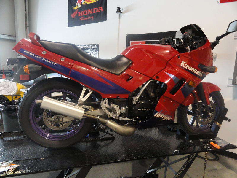

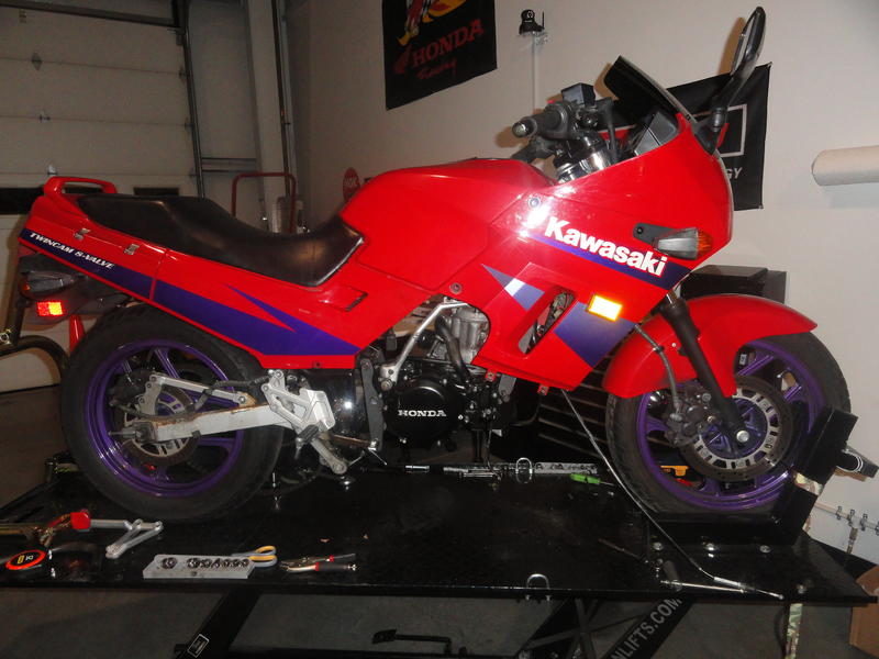

    well, i put the cr250 motor in place..everything looks good to go. Fabed the motor mounts up. I should have it bolted in tommorrow if all goes well..Dam, this bike is going to be light! Ill post up some pics
    Two many 2 strokes
    Bradenton FL
    720
    Re: Ninja 250 motor transplant... what motor to use?
    Ninja 250 motor transplant... what motor to use?-dsc02831-jpg
    Ninja 250 motor transplant... what motor to use?-cr250_motor-jpg
    Ninja 250 motor transplant... what motor to use?-cr250_side-jpg
    working on the pipe now...I keep pulling parts off..getting lighter and lighter.. to funny...

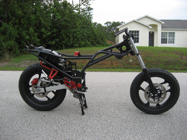

    There's a big piece of structure missing between the steering head and the swingarm pivot.
    Ninja 250 motor transplant... what motor to use?-build_cleanframe-jpg
    I don't think this frame was meant to work without the engine, or some other structure, tying the bottom of the steering head to the swingarm pivot. Without that, the stress on the remaining frame is excessive. I think you need a pair of tubes under the engine.
    Yup, there will be a cradle under the engine going up to the top. For testing, this will be just fine This is the basic test bike... mostly dyno time not alot of street riding. Once we feel this works well, we will buy a 2010 modern 250.... new body style....
    We will fine fit what we have learned on this bike to the new bike as the motor is the same.
    Im not sure about a kit....I know we will make the whole thing a bolt on deal.... We might just buy the bikes at auction and do the conversions in house.
    The kit would include
    Custom Pipe
    motor mounts
    custom kick start lever
    Programmable ignition with 12vdc battery
    12VDC coil/regulator
    shift linkage adaptor
    lets see how this one works first Working on the pipe today. Ive made some 2 stroke pipes before....not fun... I need a company to make me them so it will be a while before we can get that moving...

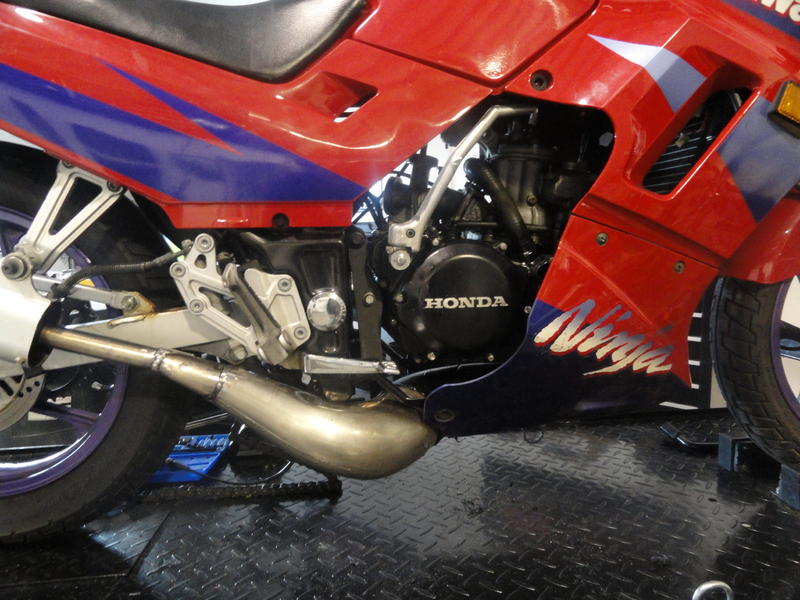

    Got the pipe mocked up...its going to fit perfect... does not hit the body at all. It does sit just a tad low but thats because the pipe is massive...nice little 2 stroke bulge.... I should have the pipe welded up early next week... I need to document the pipe first so i can make more just in case ill post up some pics once mounted... looking sweet!

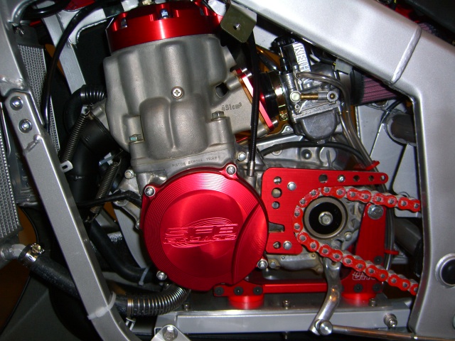

    Got the pipe all done, motor mounted... finishing up the coolant hoses. chain, throttle etc... its fitting all real nice! Lets hope the vibration is to not excessive. Top speed looks to be about 90mph.... but it should get there quick! The bike weight right now is 275lb and with 45hp....should go just fine
    stay tuned!

    #331 CBR929RE's Avatar
    Bridgewater, MA
    5,623
    needs a new case cover.

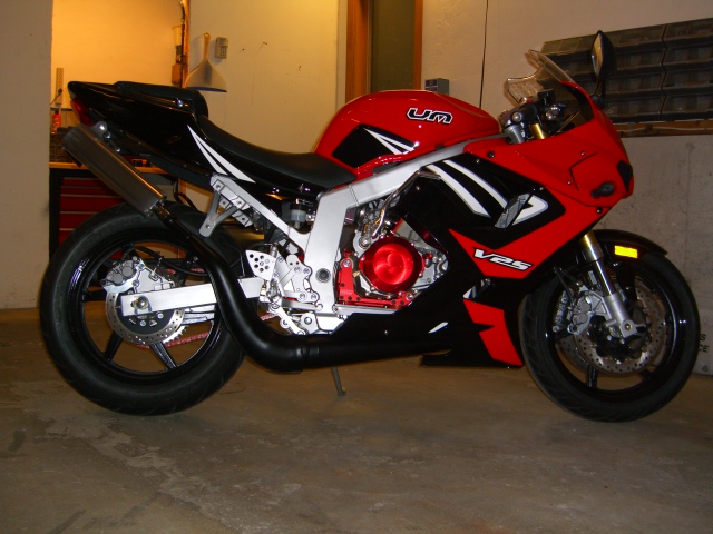

    Quote Originally Posted by DynoTune View Post

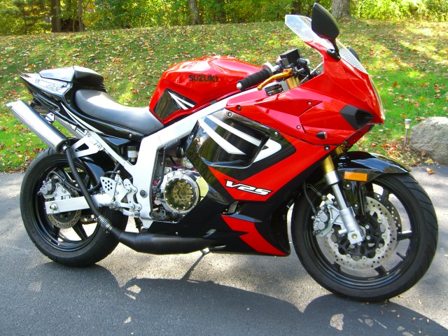

    I didnt think the quadzilla was counterbalanced.....Thats why i opeted for the cr250... I put a cr500 in a streetbike... I did the best build ever for this attempt... just to much vibration, even with custom fully isolated rubber mounts.... the body cracked, mirrors rattler bad...dont get me wrong, I could have continued to work on it but it just sucked to much.
    Attachment 36995
    Attachment 36996
    then converted to a 115hp banshee motor
    Attachment 36994
    banshee was the way to go.... smooth and fast!
    The rd motors are to low tech... plus they have 2 cyls/ pipes... trying to make it light.
    The cr250 has 48 HP....the stock 250 ninja had 24hp.... I have a cr250 motor now... im leaning this way heavy as I can get cr250 motors everwhere cheap. The quadzillia motor is very hard to find.

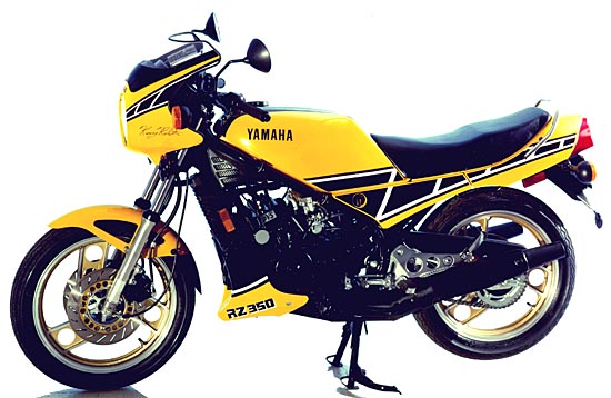

    The Banshee motor has been done before.... by Yamaha. The RZ350
