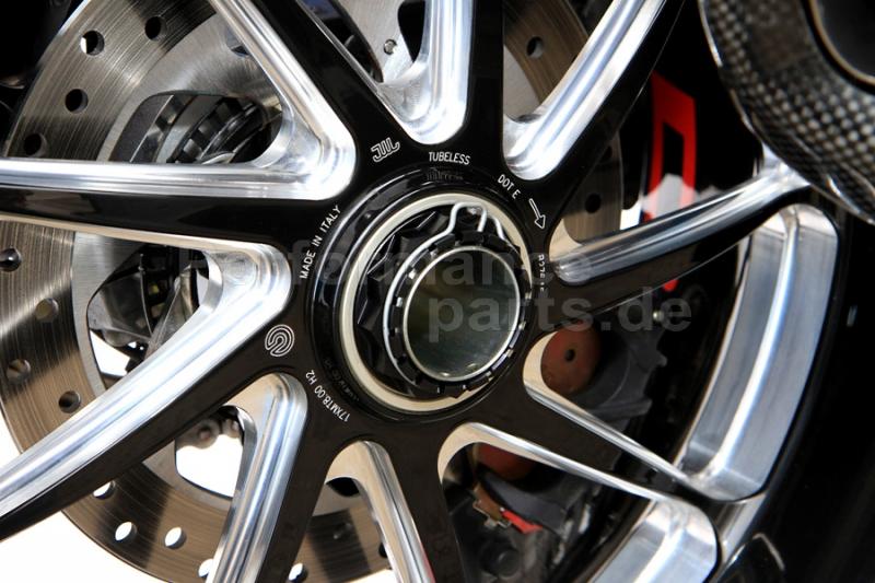

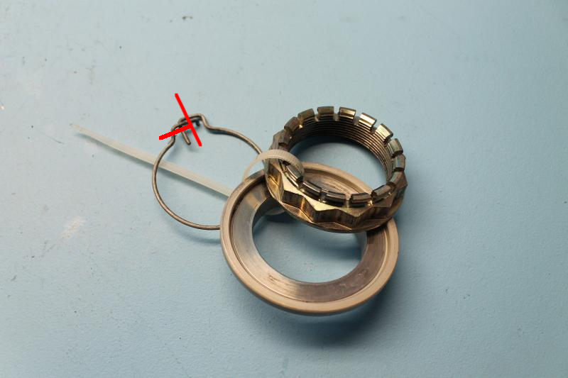

    One thing though, it looks like they've changed the clip to a new style for the 1199.
    The old style has those two straight bits, slightly angled away from each other so when you tighten the wire it snugs up and can't slip off.
    ....the new style doesn't have a similar place...because you know, Ducati.
    I'll stop pontificating now and try it when I get home.
    Edit: Those pictures were tiny - let's try that again.

    Can't you safety wire vertically and horizontally at the intersection of the retaining clip

    Quote Originally Posted by fromario View Post
    How to safety wire a ducati rear axle nut-_57-jpg
    That's what I do
