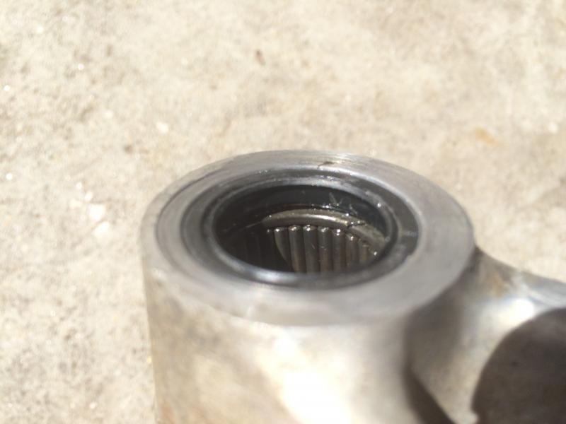

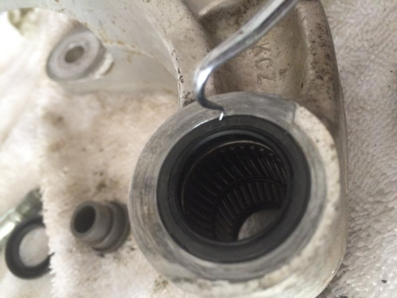

    Re: basic bike spring prep for the XR250r
    basic bike spring prep for the XR250r-image-jpgbasic bike spring prep for the XR250r-image-jpgbasic bike spring prep for the XR250r-image-jpg
    Doesn't look corroded. Grease is in there. Rubber is soft and supple. Not sure if there is a trick

    In my experience the dust seals that I have removed after being in the bike for a while haven't come out too easily. That being said when I did get them out they were damaged due to the force needed to remove them. Unless you have new replacements handy I wouldn't try too hard to get them out. If you have new replacements, a bigger flat head screw driver and prying, using something on the opposite side to protect the surface prying against and provide more leverage, has always worked for me.

    the seal most likely has a metal edge that's pressed in. if it's been there a while, not so easy to just pick out.
    i would do as gixxer says and just remove the needles, blast everything clean, reinstall needles with fresh grease. if the needles are caged, little harder to clean everything up well but from your pics, everything looks pretty clean for a dirt bike.
    i just went through this maintenance as well... found some needles missing so i removed one bearing and seal and replaced with new.
    The seals don't look trashed, leave them alone if you're not putting new bearings in. You can pop those needles out carefully with that awl, once you get the first one it's cake. Then soak them all while you clean all the old gunk out of the race (q tips work good for getting it really clean. Smear some grease in the clean race and set the clean needles back in, done.
    bearings and seals look pretty good. Spray some cleaner, blow it out with air, lube, and reassemble
    ditto , ditto . surprisingly clean as is
    I agree with this 100%, especially since it's April (time to ride!!!!)
    I usually go through the bearing repacking process in January when it's too cold to do anything else. Beer is also a critical item for the task.
    yup... i'll spray, blow it out and then lube...I have enough projects. Thanks for the input. I'll do a more comprehensive job next winter
