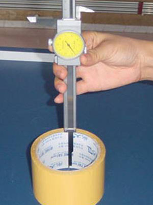

hmm, interesting. at the very least, every dirt biker should own a fork oil level tool. dead simple... but understand you might not know what level/weight was in there, or what you prefer, and CC makes things more interesting for sure.
Hmm maybe I should get a fork tool and stop throwing all this money to a sgop
Tool would make it easy, especially if you need to remove oil. But something tells me you're cheap enough for the alternatives below. If you have to remove a few mL, dip a paper towel in. And you won't overfill by a lot since you know under is better than over without the specific tool.
Or, use a caliper.
nedirtriders.com
Or, just tape a bit of fuel line to that ruler. Attach other end of fuel line to syringe or MightVac. Boom. Full tool.
That's how I do it. Overfill, then suction out to your desired fill height. Done.
Turkey baster. Good for so very many uses.
