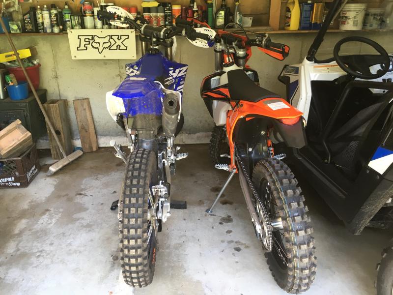

    I put hybrid on my YZ250X, it’s a Maxis standard tire that comes on the KTM Freeride 250R. It’s got a bit more knob spacing than a standard trials tire and a stiffer sidewall, while keeping the gummy trials compound. So far, it’s wearing pretty good and I’m running it around 10psi
