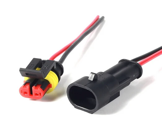

    hmm, clipped a ground wire off the starter relay plug and shouldn't have. FAIL. NO FIRE. harness is back off. think i'm going to ditch all the single connectors and go to multi-wire waterproof plugs. with the weather turning shitty again, might as well keep improving.
    that race harness is looking like a bargain now

    should be good after reconnecting that ground wire. the system is pretty simple but the grounds were ganged up in a few locations that made it tough to know if they were just for lights or more important. only other unknown wire was a yellow/red that ended up being for a dual-map switch but my CDI is single map only. bummer. would have been nice to sampe the 'soft' map on the slickery days.
    i'll feel better about the whole job if i move to these style connectors in 2-pin and 3-pin formats:
    also going to cut out the crimped unions and move to solder splice sleeves.
    i should have just ordered from the get go but didn't want to cut any OEM connectors out. now i don't care since i already cut some out, e.g. start/kill blocks. i'll be able to shorten the entire harness to exactly what i need. some leads are longer than they need to be requiring a bundle inside the frame. i can chop some of that wire out.

    NOW i feel better about this job. got my upgraded plugs, shrink wrap and sheathing. OEM spec stuff from CycleTerminal.com in Jersey. great selection and service.
    bar switch plug > harness is the 4-pin and the 3-pin carries wiring back to the starter relay. repaired the ground wire i snipped off the starter relay and ran it back up to the ground junction > coil.
    these plugs are sealed with rubber grommets and the shrink wrap has adhesive inside that melts to form an even better bond. love it.

    good to know, thanks. now that i've used those nice sealed plugs, i'd like to do a 3-pin for the 2-stator (spade) and 1-kill (bullet) wires but the harness is back on the bike and secured.
  13. #388
    Jun 2005
    6,072
    Re: typeone's Beta build (250RR)
    The only other thing I'd consider is the capacity of the wiring with the plugs. The one I have felt like relatively light gauge wire, so load could possibly be an issue?
  14. #389
    13,839
    Are you crimping pins and assembling the connector or getting them as pigtails and soldering to those?
  15. #390
    7,933
    yes, thanks, the wiring i'm using the plugs for is very light guage.
    strip > crimp x2 > assemble, no pigtails. i bought a specific crimper for the pin types. first is wire crimp, second is seal crimp. you end up with this before snapping into the connector body:
    wish i saw that he had splice terminals, could have saved me some soldering at multi-wire junctions!

    I cringe a little at those crimp joints. But then I hear they are actually superior for high vibration uses, like motorbikes.
  21. #396
    i would have rathered those (+ adhestive shrink wrap) over solder for durability. that crimp tool i bought is sweet, makes those nice folds, looks factory fresh and secure.
    i'm hoping the regulator wires do OK, they were looking kinda beat already. contemplated just redoing that joint > plug now that i know what i would need. i've got a bunch of spare wire i could use, just need the male 4-pin connector.

    Vibration causes cracks and breaks at solder joints, that's why you'll never see solder joints in proper vehicle wiring harnesses. A proper crimp connection is solid. Heatshrink over it provides environmental protection.

    yup, that's what i'm afraid of but i'm sure it will be fine, the three small solder joints are cushioned in a wrap of wire zip tied to an open triangle in the frame, doubt they would fail ... BUT now that i've done this TWICE, i'm tempted to make the ENTIRE harness again. hahaa. gets better each time ... and you know what they say about the thrid time

    If it makes you feel better, my motard is chock full of solder. I'd love to borrow that crimper setup and redo it some day.
  25. #400
    Srs??
    Dang I soldered all my YZ joints if I needed them to hold...they do..and it's rough AF...maybe over 10 years it may fail
