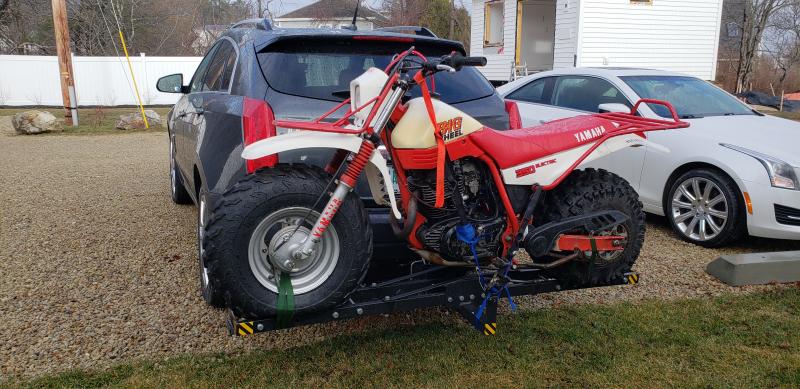

    I just picked up a 1987 Yamaha BW350 for my wife and and am making it street legal for her to bop along on the coast, I will surely use in mud/snow. Right after this pic I power washed the engine and got the loose paint off, the next warm day I will tape off the frame and hi-temp paint the engine. The carb is coming off and going to Hobbs next week..
    I have been considering removing the hand guards with directionals off my Hypermotard (go with small aftermarket directionals) and can easily put them on the BW. When I removed the stock plate holder / lights off the Hyper to put the under-tail holder on I made the mistake of throwing the stock in trash, could have used those too. It already has a hi/low bean headlight and I will use the air horn off her Ruckus for horn (also have one on bicycle which is a life saver on ocean Blvd).
    I will need a cable style front brake lever with brake light activator - the rear light activator is easily available online. Here is an easy light control fix.
    I will update when complete

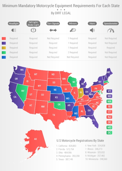

    Making Big Wheel 350 Street Legal-dot-requirements-infographic-jpg
    Thanks MHenry, there is conflicting info though the state does seem to exclude reference to directionals.
    My bike inspector told I need to find this form for him to use. This one also excludes directionals though is not a state site.

    Concord NH
    605
    Re: Making Big Wheel 350 Street Legal
    Quote Originally Posted by CMG241 View Post
    So the inspection form you attached actually references that RSA215a, makes sense.
    I would make sure to print a copy of Sections 35-39, and also Section 14 to bring with you. Then you can show the legal requirements of what the bike has and does not have/need. According to the RSA, you don't actually need a switched brake light either. Just a solid-on tail light like included on most enduro bikes.
    As I'm typing this, I think I'm going to print a copy of those sections to keep on the bike this summer, just in case I get hassled.
    I picked up a 200xcw back in the fall that I plan to plate this year, so I've been digging through all the requirements myself, too. I've already got a title though, so the largest part of the battle is done.

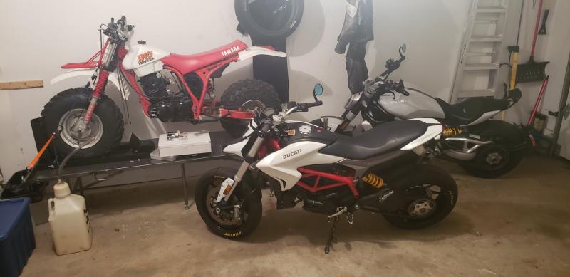

    Well it is registered, I now have a VT tag while living in NH. Hand guards w/directionals from my Hyper will go on this weekend, I have the brake light actuating handle from Amazon in a box and the rest of road legal items being collected.

    I have been lazy, the BW is sitting on a bike table in the garage so still work in progress. I registered it though never got to the inspection portion. Please update your progress with tires ty
