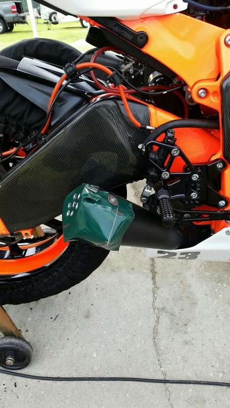

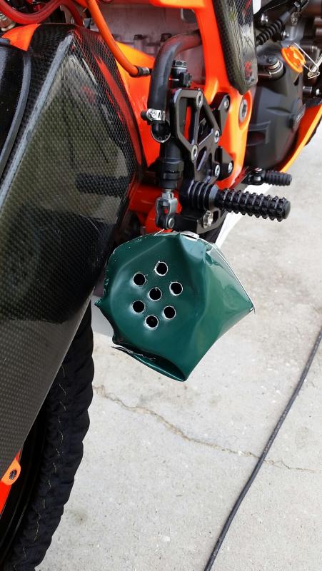

    When I was in Florida at Jennings, they had a very strict noise level that they enforced in a similar way. My buddy I was with got flagged a couple times, so we took a piece of aluminum and attached it to the end of the muffler with hose clamps. It diverts the sound. He ran the rest of the weekend like that with no complaints. I think someone used to manufacture them and sell something similar at Laguna Seca.

    This was our attempt at a homemade baffle. Looks like we did a little more than hose clamps.

    Holy crap that's awesome and hilarious!

    Worst case, rig up a sound deflector like the one pictured. It will get you through.
