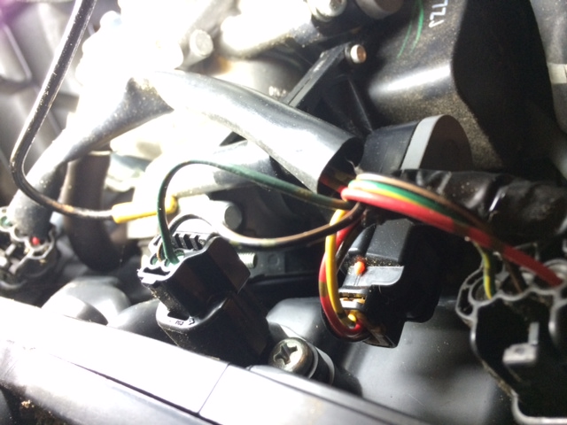

    well update
    i went down to see the butterflies, took off the tank and then saw that per the pic below the connection with the red and yellow wires was hanging loose, notc29 code SV650-photo-jpg sure why or how. as it has just sat for the past 4 months. Either way i plugged it back into what i thought wit belogned. Turned thebike over and voila code gone.
    Thanks bubba.. and golden chicken. I found the serv manual.. and was about to check the connections. guess the connection literally wasnt connected
