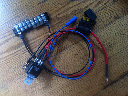

    Re: extra power source on bike? how- to?
    I picked up this power distribution kit from a guy on SVrider who makes and sells them:
    http://www.svrider.com/forum/showthr...06#post2486706
    extra power source on bike? how- to?-6970267959_0b8a6a144e-jpg
    It didn't look TOO complicated to make on my own, but I suck at electrical so it was easier to buy it from him, then tap into the headlight wires coming off the fuse block to get switched power for the relay.
    Once thats there its very easy to run usb/lighter outlet power off it.
