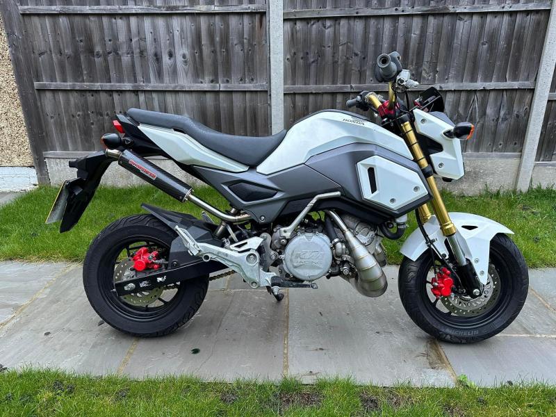

    Norf Sho
    13,003

    How much is in this thing at this point?
    -Alex

    12,710
    Re: Grom build
    i'm the 3rd owner. the motor build and labor was about the cost of a new Grom. everything on these bikes are fairly cheap. for example: the brembo calipers are $90. Ohlins fork internals are $275.
