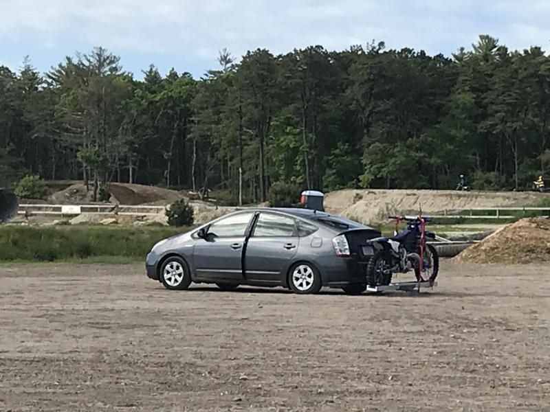

    Rocky Mountain sells Switch Hauler. Weight limit is 350. I use it for KTM 250 SXF on SUV with no issues ever in the last 5 years. This thing is SOLID. Can’t put street bike on it though as they are usually over 350
    5,335
    Re: Opinion on Hitch Hauler/Carrier
    Quote Originally Posted by Momoney7878 View Post
    Lots of people look at the weight limit of the hauler itself. Far fewer people look at the weight limit of the tongue...
    I took this picture at Wareham in 2018:
    Opinion on  Hitch Hauler/Carrier-img_3543-jpg
    Jun 2019
    Cape Cod, MA
    Hahaha PRIUS! Of course. The Switch Hauler works with a class 3 hitch which is 600 lbs tongue weight limit.
    You can put a Class 3 600lb hitch on that Prius, but that doesn't mean you can now put 600lb to it. The vehicle also has it's own weight limits no matter what hitch is installed.
    nedirtriders.com
    5,335
    This. The hitch limit on my Curt hitch is about 150lbs more than the tongue weight limit from Subaru...
