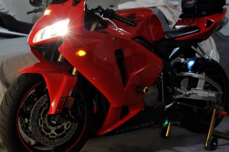

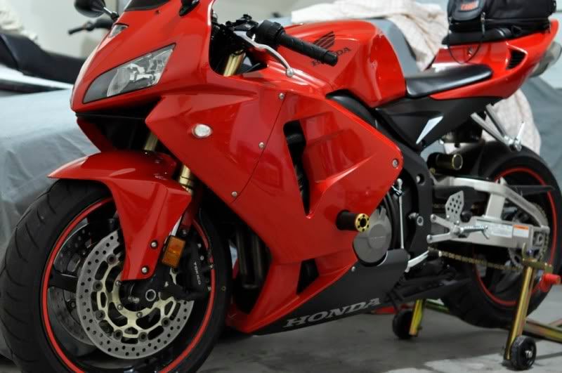

    I have a 2005 CBR600RR and I was surfing my car forum and came across a fellow with the same bike, but his had all the tribal taken off.
    It just looks so much more clean without all that tribal madness. Has anyone on here done this before? I was gonna embark on this and could use some tips/help

    Jason the only graphics on the Honda that are clear coated are the tank graphics (if the fairing is stock that is) so you wont be able to take off the little tit of the triangle on the tank cover without sanding off the clear and messing up the paint. All the other ones can be taken off by the processes these guys posted.
    I've taken some of the decals off the plastics I bought this winter for the track.
    Also, the bike in the picture is red, do you have the tribal graphics on a red RR?

    yea i have a red tribal'ed RR. i figured it would look sleeker, and thanks for the input, i will most definitely try this next week when the bike is back on the road.
