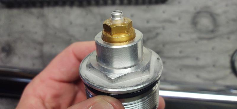

    I'm confused. Can't you just pull the spring down by hand and slip the 19mm on the jam nut?
    Not keen on the idea of the wrench being pinched by the remaining spring tension between the collar and the bottom of the fork cap. Even with preload backed all the way off, everything is still loaded a fair bit, IMO.

    I'll go out on a limb and say these forks have never been apart. No tool marks on the adjusters or related hardware.
    Questions regarding 2012 R6-img_20220328_145150213-2-jpg
    And below is the DIY spring compressor shown with spring compressed. Some changes from the first use are that I hooked on the carriage bolts on the inside of the PVC ring which allowed for more stability at the carriage bolts since it's pulling closer to the collar. I also decided to use a sliding strap instead of a ratcheting one for more control over compressing and relaxing the spring.
    Questions regarding 2012 R6-img_20220328_175440663_hdr-2-jpg
    A couple things I learned with regards to setting the depth of the bolts in the collar, first, I centered the tool over the fork leg and set a conservative depth on one bolt then locked it down.
    I then made up the distance to the collar with the loose bolt and locked that down, making sure not to contact the damping rod. There's got to be close to 1/2" of play inside that collar so, plenty of room to hook onto it without risking damage to the internals.
    This DIY spring compressor isn't a perfect science. It will walk around a bit when tightening as well as releasing the spring and it does require paying attention so it won't get side loaded, for example. But it's otherwise safe, stable and easy to use so, in the tool box it goes.
