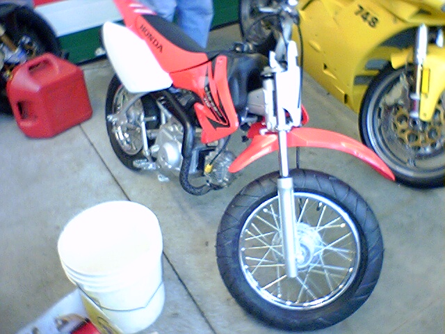

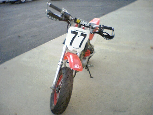

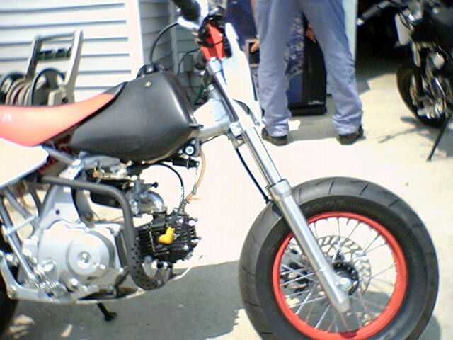

    Heh, the trick to putting fatty tires on narrow rims is to get tall sidewalls. A 120/70 on a 2.15" rim looks ridiculous, you can't use the anything close to the whole tire. A 128/80 on the other hand presents a usable profile.
    Useless: Can you SuMo a CRF80?-dsc00095-jpg
    Useable: Can you SuMo a CRF80?-dsc00135-jpg Can you SuMo a CRF80?-dsc00181-jpg
