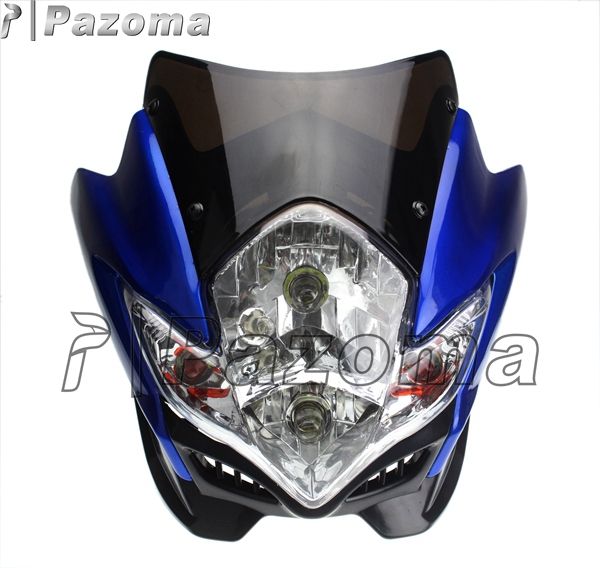

    I'm going bananas trying to find a headlight for my 05 SV650. GSXR front end with none of the stock mounting brackets so I'll be doing fork brackets or just making a custom bracket up.
    I really dig the look of this crappy Pazoma eBay special, plus it's like $30 with integrated signals:
    But.. it's probably a POS and isn't DOT certified.
    There seem to be some decent 7" round lights with 50mm fork brackets that would work, but not really a huge fan of the style and the good ones like JW Speakers are craaazy money.
    Any ideas for a setup like that Pazoma with good lights? Almost thought about doing a stock GSXR upper fairing/headlight and getting the fairing bracket to mount on the SV. I'm really not a fan of the SV650S nose.
    Totally open to ideas, just can't seem to find anything that I like.

    for 30 bucks it seems like its well worth the chance it'll be good. If you like the looks once mounted and the output isn't great you could always try with an led bulb or doing an hid retro fit. Space looks tight it looks like the top light opening is a possibility.

    Those look like wimpy 30W bulbs. Housing won't be able to handle the heat from real bulbs.
    A lot of people go with their choice of GSX-R headlights with the extra tabs cut off and make some brackets to attach to fork mounts. They aren't too expensive on the bay, either.

    Most of those cheapo aftermarket ones do suck for output. If you do go with one of those, at least make sure It uses a standard bulb (H4, H7, etc) for the headlight, and you at least stand a chance of a decent output. A bunch use shitty non-standard low-wattage bulbs for the main beam, like turn signal bulbs as a headlight. I'll see if I can dig though my eBay history to find the one I put on my F4 to sell it, it looked decent and wasn't too too shitty.

    And that's the problem, if they can handle the heat they wouldn't be cheap... but I guess LED might be possible.
    The Pazoma guys are away for two weeks for Chinese new year but I shot them a message. For $30 I'll probably grab one just to experiment with anyway.
    I'm starting to lean toward the GSXR headlight strongly. I feel like it runs a good chance of being super ugly but this might motivate me to customize something, or get the entire upper fairing and chop stuff off. Hmmm...

    Ok yeah, the one you're looking at has 18W high and low beams - definitely not a standard headlight style bulb.
