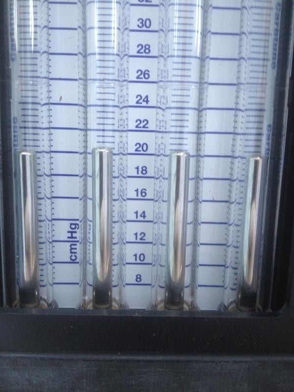

    Apr 2011
    Rockland
    225
    Re: Wanted to get a Throttle Body Sync
    ended up syncing my TBs last night and went from this
    Wanted to get a Throttle Body Sync-beforesync-jpg
    to this
    Wanted to get a Throttle Body Sync-aftersync-jpg
    in about 20-30 minutes, took a short ride and vibrations and buzzing are mostly gone.
    Quote Originally Posted by 7UPyours View Post
    to this
    solid work man!
