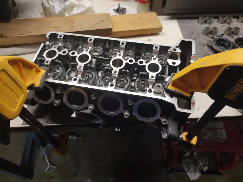

Clamped the head to my bench, folded rag in the combustion chamber to support the valve, deep well socket and a hammer and was able to walk the 3 shims out
Attachment 61891
Attachment 61891

Holy hell, something bad has been going on in there. At this point, I'd be tearing down the entire head and sending it out for evaluation and a rebuild. Your valves are suspect as well as springs, retainers, cams, etc. Might be new head time.
Oh fuck........
The head is already apart.
Everything so far is in excellent condition with the exception of the 3 shims, one upper valve spring seat, one valve spring and I'll be replacing one of the buckets as well just because I don't like the polishing that happened from making contact with the spring seat.
I believe this is the result of low quality shims since everything else checks out so far.
I think they're Temu shims and nothing more. The attached pic gives an idea.
