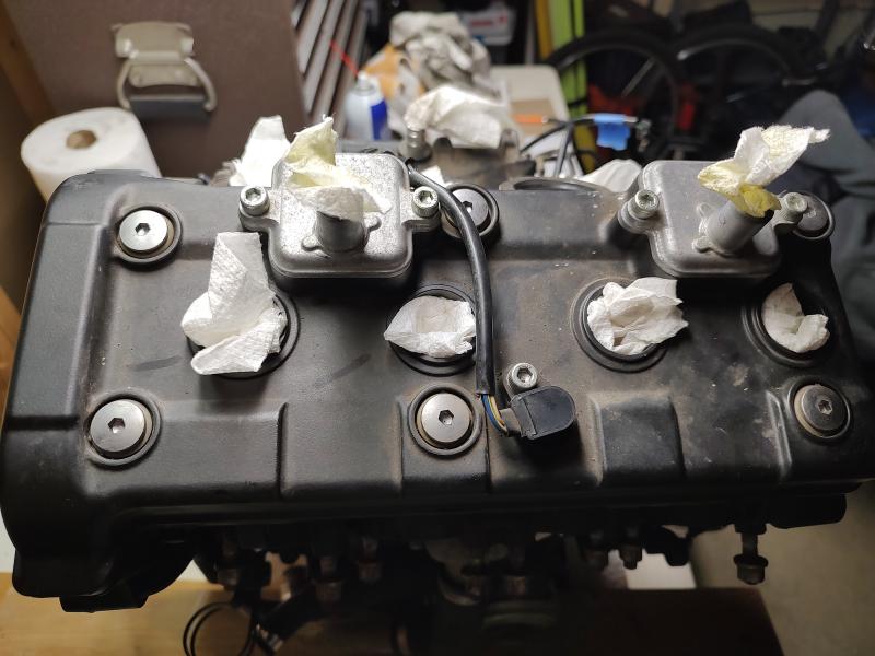

    Upon removing the valve cover to check out the cam lobes, I was greeted with a camshaft end cap that fell out at some point in time but thankfully the clearance to the valve cover prevented it from floating around. That was a bit unnerving to see but disaster averted!

    Wait, what happened? A cap was just loose in there? THe bolts were in position? These thing strip out like chocolate. It's often possible to fit a longer bolt if you have stripped threads. Either way, I would meticulously clean out the holes and check valves before putting the motor back in place. The cam lobes look pretty mint to me. considering what they do, there is always going to be some marking and discoloration.

    Some people install the caps with a little less torque than the service manual states.

    Not the camshaft caps. Haven't gotten that far just yet. There's a friction fit part that's pressed into the ends of the cams. One of them somehow friction unfitted itself.
    3rd pic down, the end of the left cam (exhaust) has the cap in place, right cam (intake) does not.

    Oh, weird, I didn't know that thing existed.

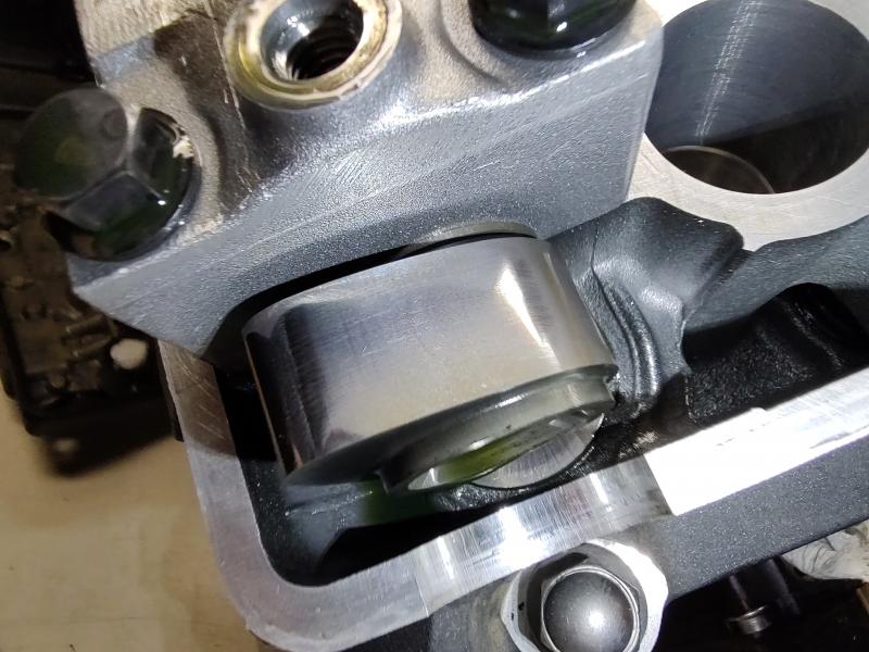

    Anyone have a remedy for mushroomed valve shims?
    Countdown until the 2025 NEMRR season!-img_20250223_202555792-jpg
    Like the shims won't come out of the buckets??
    Upper spring seat but yes, three are mashed in.
