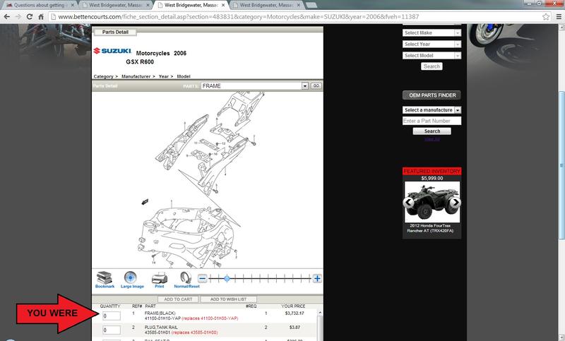

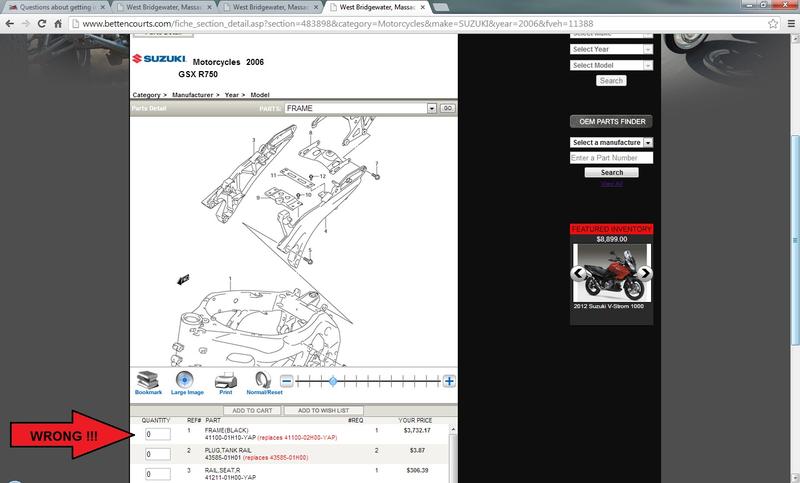

    hate to say it, but....

    it was discussed in another thread that the only difference between the 600 and 750 on the 06/07 GSX-R's is the motor, ECU, and air box. he was stating that a 750 frame wouldnt be MW SS legal, even though they're the same frame for the 600's. VINs are only checked for contingency purposes.

    that thread we discussed was about his 06/07 750, which is why i kept saying the frames are the same. all suzuki dealers have the micro fiche on their website.
    as far as CCS, i've discussed this as well with Eric in Texas. the 06/07 600/750 GSX-R frames are interchangeable since their OEM and don't change the weight or geometry of either bike.

    Only because I find this bantering back and forth very comical, laughing at my desk comical.
    The part number Jim refers to as being the same is not the original part number for the frames it is a superceding part number
    The originals as per Jim's photos
    GSXR 600 41100-01H00-YAP
    GSXR 750 41100-02H00-YAP
    Clearly different part numbers.
    Oddly looks like both Josh and Jim could be construed as correct depending on the interpretation of the parts listings.

    They are the same.......just like the 2011 GSXR 600/750 Oil filter has a diff part number but isnt any different from the previous ones. They are the exact same filter as I have used an 06 filter on a 2011 (cause Im super crazy)....they just changed the part #'s in 2011 and now they come in a plastic package and not a Box.

    Oh I definitely understand that they are the same. Like I said I just find this discussion funny and figured I could fuel it along.
    I have worked for companies that have many parts where the only difference between two items is the part number due to the customer purchasing the part.
