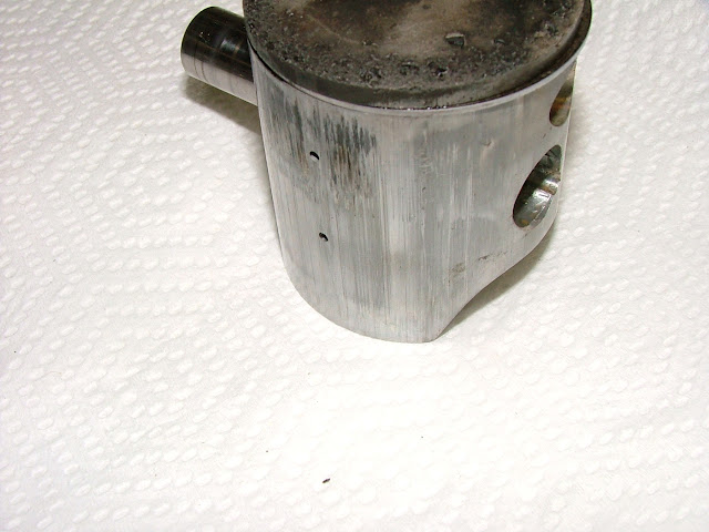

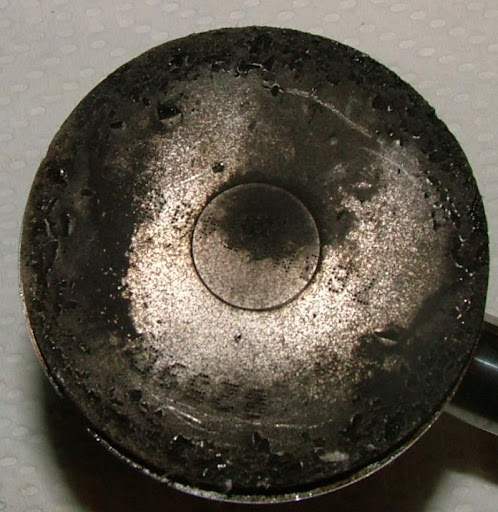

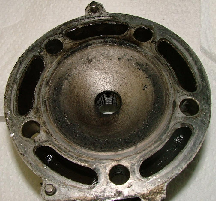

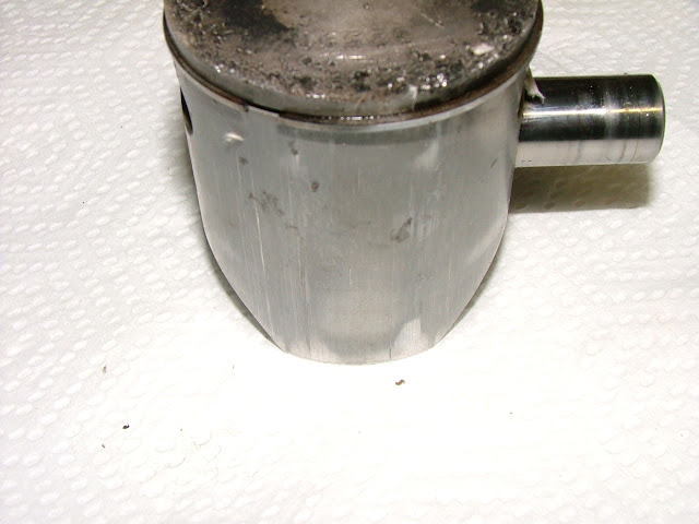

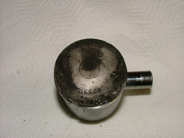

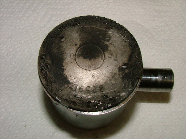

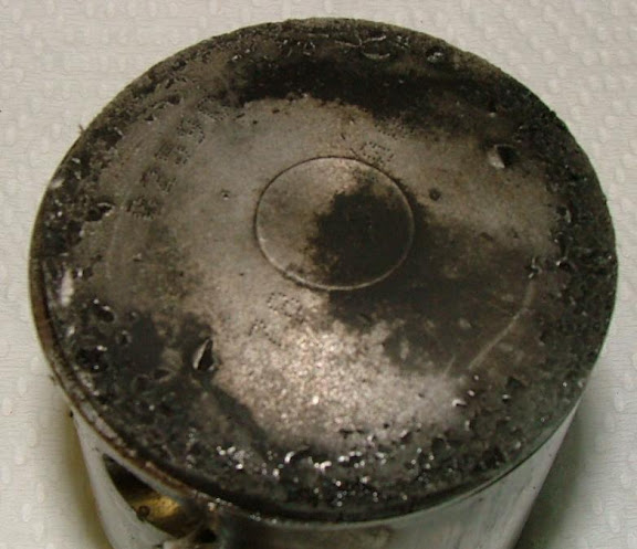

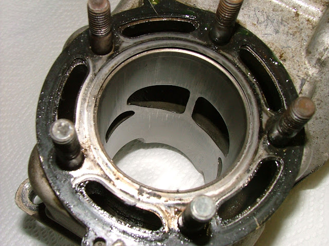

    Update: Cylinder and sides of piston look fine. One small scratch on piston side I can catch with a fingernail, but overall the side is fine. Cylinder appears to be mint.
    The top of the piston is way worse than I thought, and there are matching marks on the cap (don't know why I didn't think to look there when I saw the top of the piston the first time).
    Pics to follow as soon as I can get some decent ones, which is proving to be less than easy.

    Re: Determining Cylinder Bore?
    Here are the pics. I'm no mechanic, nor do I play one on TV, but I'm pretty sure I can file this shit in the "not good" category.

    Sounds like it needs to go to a machine shop, no need to fuck around when you have mechanical damage.
    Thanks for the reply. If it comes to that, I can probably order a big bore kit for what the machine shop and new overbore top end (plus probably new cap, we'll wait to hear what the guys in the know say) would cost. Hop her up to 145cc and bolt on replacements to everything you see in the pics. I'd like to get out of this for less $, but I'm not optimistic after looking at that cap and the top of that piston. It'll be interesting to hear what people say now that I've got the pics up.
    15,250
    That looks mostly like detonation. The bike was run lean for quite a while. If there are no broken parts, like the plug wire, ring, or circlip, than it's definitely purely dets.
    The head cam be fixed by a machine shop. I would have them measure the cylinder for roundness and/or bellmouthing. Might be time for a replate.
    Thanks for the reply. I guess the question is will the machine shop + top end kit be as much or more than a big bore kit?
    No broken parts at all. Plug wire looks good, circlips were fine and both in there, etc. Aside from the top of the piston and the cylinder cap everything looks good. Even the cylinder itself and the sides of the piston look good.

    Do a check online to see if oversized piston and rings are available for your bike. If the cylinder has a coating there's a good chance it might not be borable.
    The damage in the head and on the top of the piston is from detonation. Take the carb apart and make sure it's clean (always a safe bet on a 2 stroke), make sure the right plug was in the bike, and that the timing hasn't been messed with (might not even be adjustable). You might get lucky and be able to get the head machined so it can be reused, but most of the time it needs to be replaced. A word of warning about the big bore kit - there's already something amiss in the engine - it won't go away by itself.

    Don't bore it. Fix it. Replate cylinder (if needed), regrind head, new top end, check jetting and timing. Ride and enjoy. Send the head to someone who works on lots of kawi 2strokes. I'm sure that can be cleaned to an acceptable level. You're looking at about 300 bucks +- to get things sano.

    Knowing the background on that bike it could be that it went WAY to long with out proper maintenance, it should have had a top end a while ago. Could have had some shit get into the combustion chamber at some point. I would wait to change timing or jetting until you have the new top end in. You will be able to tell if the jetting is right after you run it. And the compression will effect how you want to time it.

    The BR9ES plug certainly didn't help things - the EX plugs have a much finer electrode, and gives the engine the ignition pulse it was designed for. Do a quick check on the jets you pull out of the carb to make sure they are in the right range (a lot can happen to a 2 stroke in 7 years). If the previous owner put a pipe or silencer (or both) - check to see what the recommended jetting is for them.
