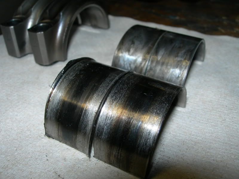

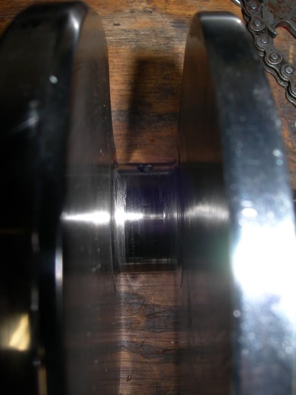

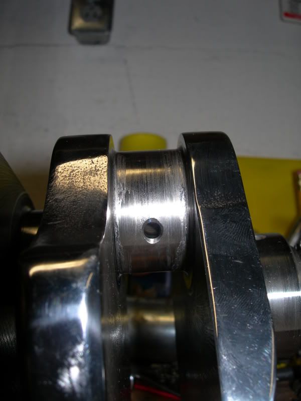

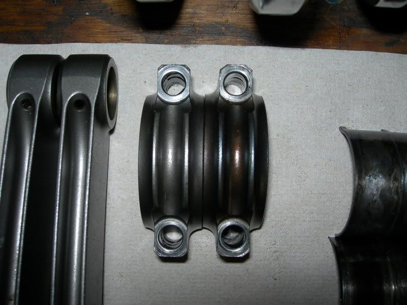

    The big question is whether or not I can re-use the crank or even reuse the cooked rod?
    This was Black Squirrel 441 (AKAMongoos441) engine. He had a number of what I believe to be were seizing moments that led to a total failure down in Jennings FL. One of his crashes he believed was because of a vapor lock. I think it was a seizure. One day he brought it over my place to be worked. Come to find out it needed 2 quarts of oil. This was a warning. In turn we did a total oil change only to find out that the oil was metallic. I told him that I think there is more to this engine than just being down 2 quarts of oil. Before he headed off to FL I told him to constantly monitor the motors performance and be ready at a moments instance to pull the clutch in at any moment.
    Well he listened. The motor had a total seizure and he was able to keep the bike upright by pulling the clutch in.

    For a Motor That was Dead, It was fast as stink Really Fast. Ask the 12 SV's I beat un LWss. The first time I rode it. It also Won a race when I had my hand up and the bike in Nuetral when the green flag dropped (wave confusion) From the last row I launched when the first Row was into turn 1. The highlight of my racing to date. If the motor did not fry I would still be racing it
    I hope the is something there you guys can use,

    Usually cranks and rods can be cleaned up and bigger bearings used. I dunno about bikes, but I've done it in cars with a spun bearing. If it seized the rods should be checked if they're bent. It needs to be sent to a machine shop that specializes in motorcycle engines.
    My education rep. in the VA is friends with a guy in Maine that does crank work for some racing teams. I forget exactly what he told me, but do you me to find out his info?

    Personally, if it were my race bike, I would buy new rods and have the crank checked and balanced at a reputable engine builder's recommended machine shop. Once all that is done, you can measure and order the appropriate bearings. Honda sells a shitload of different thickness bearings.
    +1 I agree. Rods are cheap enough. Unless the crank is toast you can get it repaired.

    Looks like it went zoooooooooot ya spun the bitch. not that bad IMO get the crank polished fit the new bearings bata bing. I've busted rods doing the same.
