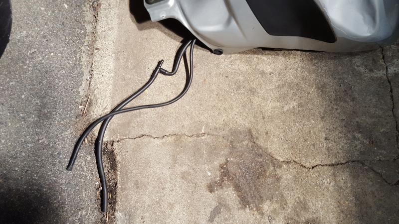

    Can someone help me figure out what is supposed to go into the open end of the T fitting in the picture? I cant remember for the life of me. I pulled everything out in a hurry months ago.

    You should post a more vague photo? Maybe stand in your neighbors' yard and re-take. Or possibly cover the lines and hide them from view.
    Could be a vacuum line for the automagic petcock. Although I kind of doubt it as the other end is open.
    My guess is a drain for the overflow around the filler opening. Entirely optional for your needs.
    16,909
    Re: Hoses coming from SV tank
    My bad. You're a gen 2'er. You have a fuel pump and such.
    My guess is still a vent.

    Are there miscellaneous hoses that do not appear to be connected anywhere? Possibly leading to or away from an overflow? That would be my guess.
    Windham NH
    2,026
    Isaac wins. I think the coolant reservoir attaches to that
    39,521
    Yip... drain hoses. Gas & coolant probably.
