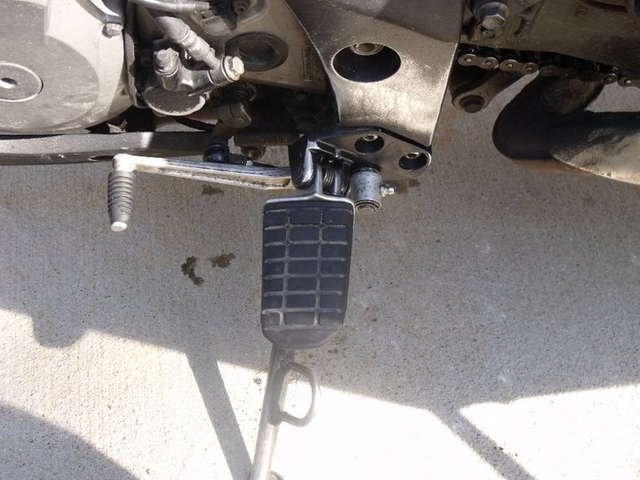

    I use Mercury 2-4-C lube. It's used on propeller splines underwater and seems about the best thing I've found so far. I've been meaning to drill it, tap it, and put a zerk on it...
    72
    19,087
    Re: best lube for shift lever
    Quote Originally Posted by stoinkythepig View Post
    I drilled and tapped my shifter last year
