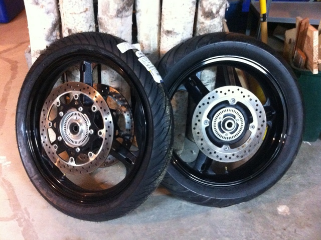

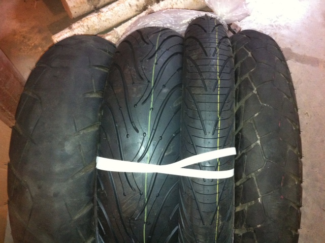

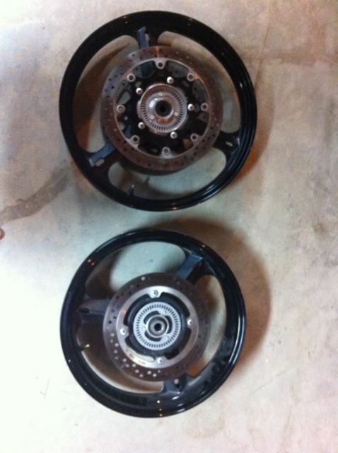

    Changed my first ever set of tires last night. It went well.. mostly. I wish I could report it was way easier than I expected. It wasn't.
    I had fun posting this on FB with the caption "low crime area my ass". Several of my friends thought I was fer serious. I got one frantic sounding email from my cruiser riding buddy asking how that happened.

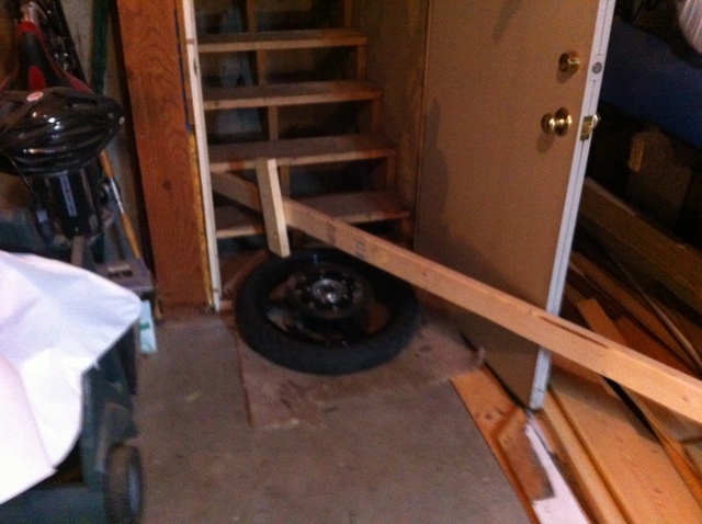

    Bead breaker. That's some scrap 2x4 sheet-rock screwed together wedged under the stairs to my basement walk-out. I know class, yo.

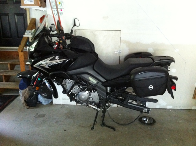

    Put the valve stems back in this AM. Tonight I will inflate, clean, and reinstall. Here's hoping I did it right.
