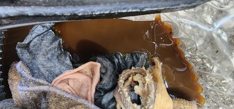

    Hello, I picked up a 03 sv1000 with title for $1000. Non running and with s list of things it needs from the sellers "mechanic ". I managed to get 12v power to it, lights, dash work. I also managed to get the bike to turn over, but not start. I removed gas tank (full of rust) I made a tank,just to get fuel to it. Now, no spark...realized it's missing a boot to the coil wire, and no spark plug. Picked up coils and wires, new plugs. Now it's getting spark and turns over, almost starting...looked down at my feet and looks like oil, alot of it, and everything motor spins over, more comes out. Here we go...I'm not sure it's oil, as it milky as in appearance to when a car blows a head gasket...looked further...I'm thinking it's dirty, old,watered down hydraulic oil from under ( to the left)the front sprocket. Am I correct? Any of this sound familiar to anyone? Think I may have wasted $1000 bucks...

    Parts bike most likely. I can't recall if those have hydraulic clutches but it's possible that's what your seeing.
    My advice would be to toss new motor oil in, go over it quickly and see if you can get it to start on starter fluid. Don't mess about with gas or anything. Down and dirty style before you start sinking money into it

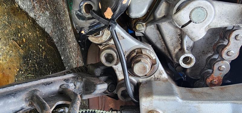

    Seller said he got it from an estate sale, and knew nothing about it. Which after talking with hom I could believe, as that's what his wife does for a living. And he's never Rhode a bike in his life. I took pictures of where the fluid is coming from and a vid. But not sure how to post them here.

    I don't know enough about those bikes to say for sure what's going on. Maybe someone else will chime in. Your gonna have some work ahead of you either way and with the zip ties I see already it's probably not gonna be great.
    Can you post up pics of the whole biie? It really might not be worth your time to go any further. Those bikes are pretty uncommon so getting replacement parts may be near impossibly if it's not complete. That gas tank for instance will plbe problematic and know for sure the fuel pump will be

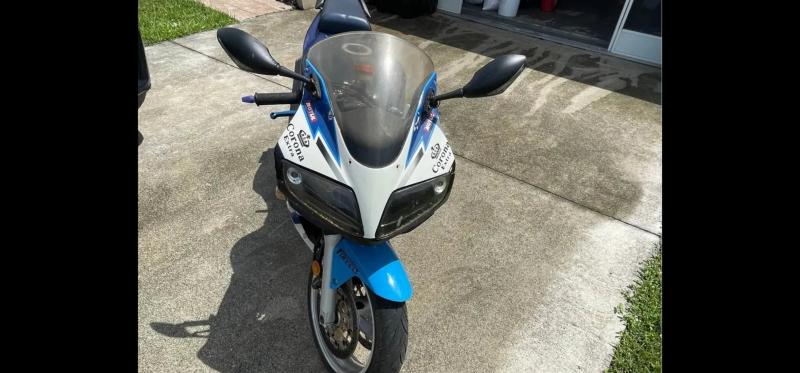

    Looks decent. Did you get a clear title
    Re: New here, and I have issues lol
    Quote Originally Posted by Psjbatman View Post
    New here, and I have issues lol-screenshot_20240915_100809_gallery-jpgNew here, and I have issues lol-screenshot_20240915_100809_gallery-jpg
    So its a SV1000 with a TLR fairing?
    Yes, clean title
    If your saying this, you know more than me lol this is the way I got it. I'm feeling a little discouraged and maybe wasted $1000 bucks..idk
    holland ma.
    3,568
    Im pretty sure thats the sv1000 nose with aftermarket side panels so no tiller stuff.

    Thats good. Means its worth at least something then. Usually estate bikes have no title or worse, one thats partly filled out. then your screwed.

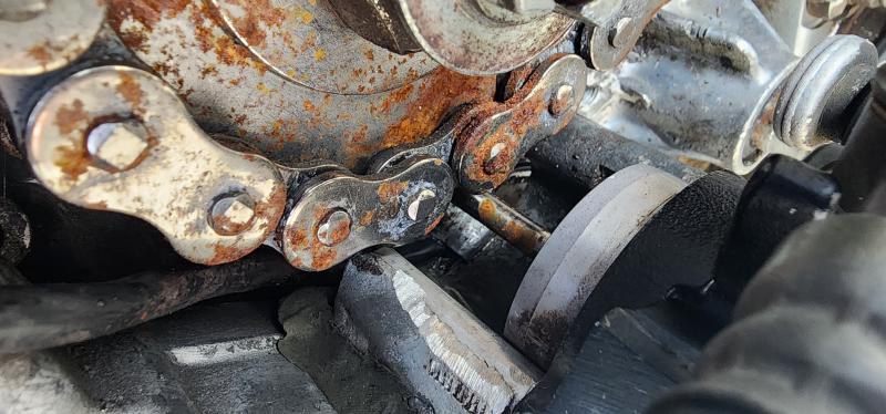

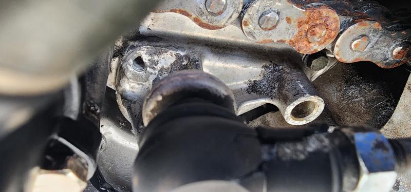

    I got the bike to fire up, then die. Of course it's by using gas in a spray bottle. Atleast it will turn over and start up briefly. I looked a bid more closely at the area around the bottom of the front sprocket, noticed it's missing a few screws, and the rod/plunger bar looks a bit old...I don't see any cracks in the block,head area and gasket between looks clean and dry. It's coming from the lower side, just left/bottom of the sprocket , in the area of the rod/bar...but I don't see it coming out there, more right above it. Not sure if any of that makes since lol. My apologies, and thank you to those replying.
    Could be the shift shaft seal but hard to tell from the pictures, I will say if the brown stuff is coming out of the engine, I would stop trying to spin it over and drain the oil, change the filter and put in new before you do more damage.

    Looks like you have a cracked case. It threw the chain at some point at least. Many cracked an damaged parts in the chain area. You have to clean up the area to get a better look. take off the front sprocket as well. Dont try to start it anymore. that much oil on the ground is absolutely engine oil so its a hurting motor.
    I absolutely agree. That amount of oil is more than the entire hydraulic clutch system can hold.
    Unless you have a spare SV1000 motor lying around, I'd recommend walking away. Putting in another $2,500 (plus a hundred or so hours) to have a bike worth a lot less makes little sense to me.
