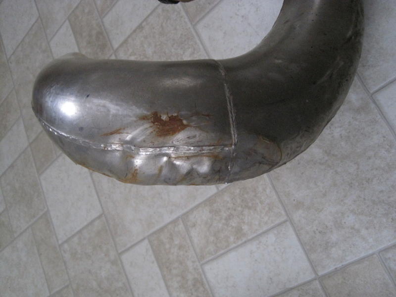

    So, I completely collapsed my stock pipe during the PSTR Swanzea event. I almost threw it out, thinking it was un-fixable. One of my fellow competitors referred to it as a "soup bowl" lol.
    I was bored last week, so I filled it with water (80% full) and put it in the freezer overnight. Took it out in the morning to thaw. After doing this 5 times, the pipe is now the exact same shape as a new one, so it's fully usable again. Obviously, it looks like bloody fucking hell, but I don't care because I have a guard going over it.
    Hopefully this helps somebody on here who has a dented up pipe. And a beer fridge in the basement.

    It's weird - I tried outside first too. No change. The magic happens in the freezer, and only after probably 8hrs or so. It seems the ice forms first, then after it's solid the ice kinda expands more. That's what does it. Hopefully I'll have before/after pics tonight.

    Ice trick for fixing your 2t pipe-img_0672-jpg
    From the giant rust spot down was all pushed inward like a bowl. It's not pretty now but it'll work!

    It was totally crushed. That's a marked improvement.

    Nice results that looks much better. Just a couple of questions:
    Did you have to seal off the ends of the pipe or just fill it with water and if so what did you seal it with?
    Also my pipe has some small "pin" holes from the dents should these be welded first so they dont expand with the pipe?

    Pigman - I was gonna send it to Pacific Crest but I was looking at $90 plus 2-way shipping. I bought a Gnarly already, so this is basically just a backup anyways. Figured I'd try to save the d'oh ray me.
    Mike P - definitely weld the holes. You may end up with more as it pushes back out lol. Don't seal the small (silencer) end. Use a 1 1/2" plumber's test plug on the big end. Fill 80% thru the small hole. It's kinda cool ice will actually flow out the small hole. That's how much the water expands!
