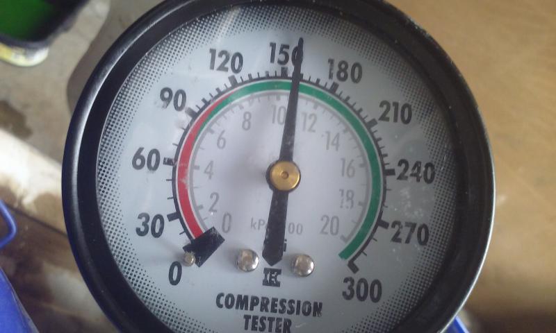

  22. #272
    Re: street legal 2-strokes
    4-5 kicks and she runs!
    Compression while kicking it over felt good...right around 160psi....perfect!
    Attached Thumbnails Attached Thumbnails street legal 2-strokes-20150507_160431-jpg
