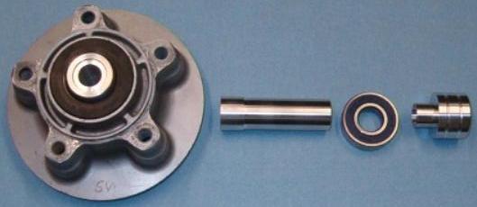

    Zoran sells them at twfracing.com for only specific wheel, usually those used with SVs.
    (Example: http://www.twfracing.com/PartsPages/...pspacersr.html)
    One thing to consider is that you may need to buy different bearings designed for the captive spacers, which means no longer using a stock bearing or stock substitute (like All Balls). The bearings would have a larger inner diameter to accommodate for the spacer.
