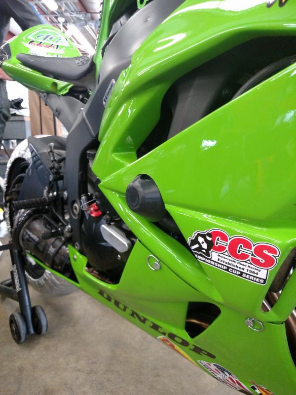

The key is to have them the right length. Remember that they are not "bodywork sliders" and that any slider that is long enough to keep your fairing from getting scratched in a driveway tipover is likely to also be one that will flip the bike when you crash. There are a ton of factors to how far a slider can poke out of the fairing, but the lower the are the less they can stick out. Also, if the base is longer, it's always going to be weaker. This is why we make direct our sliders for Ducati's (for example) typically with support braces and why we make them for a Ninja 300 (for example) that sit behind the bodywork. The more I see guys crash on them (the behind the bodywork sliders) the more I like them. Yes, the bodywork gets scratched (news flash - it was getting scuffed anyway) but when it's trapped between the slider and the pavement it almost never breaks. Guys crash those little bikes multiple times and can just keep slapping decals over the scuffs - it makes the bodywork actually last way longer.
Lots more I could say, but that's my two cents for now. We started making these new "domed" sliders last year, and I've had guys retro fit them on lots of our kits. They are a little wider at the base (so you might need to open up your hole in the bodywork) but the sloped edges simply don't catch on things when sliding. It's what I now run on all my personal bikes. Below is a sample of an adapted kit (a 2011 ZX6) with our domed slider on there.
