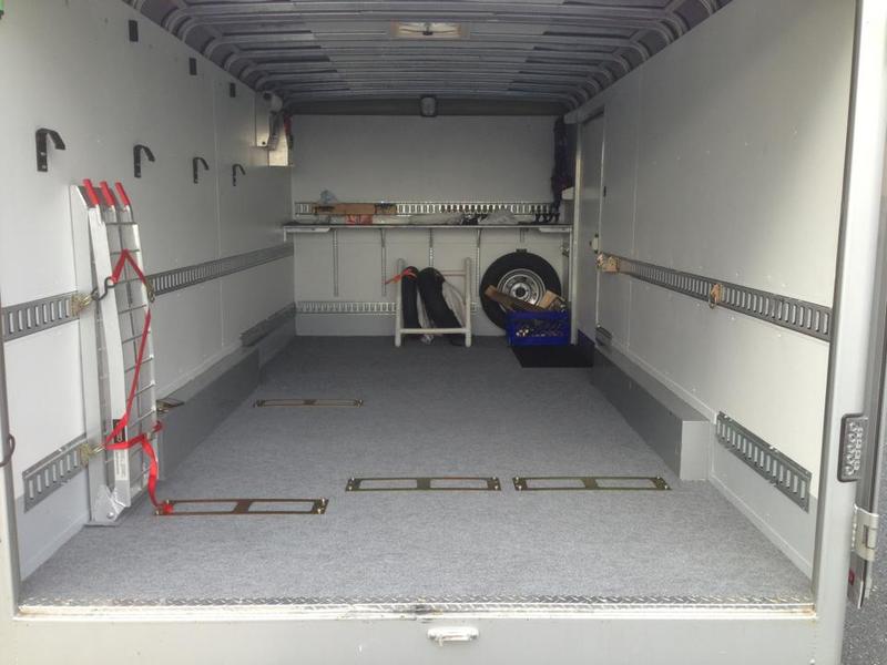

    I built a PVC tire rack (against the front wall of the trailer in the pic). It's expandable out to hold up to 4 or 5 wheels (depending on size) and I put two e-track fittings on the vertical tubes in the back, so regardless of how wide, it will clip to the trailer wall. If I need to, I can quick tie one or both tires to the outer tubes to keep them from banging around. Usually I'll put a towel or something over the rotor to keep them from getting scratched. Usually they line up perfect, with the front rotor next to the side of the rear where the sprocket would be so they sit rubber to rubber.
    totally stealing this idea (with some minor mods) for my trailer. Been trying to come up with a cost effective way to secure all my spares for transport. Bungees against the etrack works but takes way longer to load than I really want to spend. This would be awesome though, toss em in and hit the road. With 2 or 3 (depending on whos bike I'm also bringing with me at the time) sets of spare wheels this would save me a ton of time and bungees
