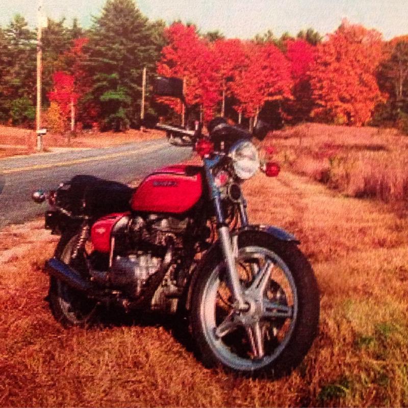

    I always found the comstar wheels part of that bike's charm.
    1978 Honda 400 Build-img_0542-jpg
    This is probably 1994-ish, not far from where I grew up. I wish I had a better copy of this photo.
    Everyone in my family got their licenses on the back of that bike.

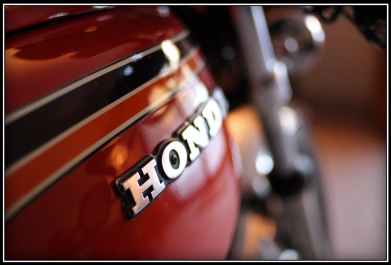

    Did a simple spray wax on the tank, and I think it looks great for a 1978
    But there is some chipping on the bottom. I'm not really worried about it cosmetically, I am more worried about it rusting. Any way to repair this without painting the whole tank?
    I'm thinking find some Rustoleum that's a close match and carefully painting it on?
    16,726
    Re: 1978 Honda 400 Build
    Those paint chips have been like that since I was 17 or so. I had that tank on and off a gazillion times.
    Boot on the shock was me fucking around. I had visions of a scrambler kind of look. Wouldn't be surprised if there is the other boot somewhere in one of the tubs I handed you.
