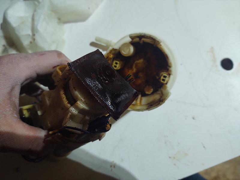

    Worked on removing the fuel pump tonight and it's not looking good for the entire assembly. The plastic seems fine, it's the bits that fit inside that are toast.
    Both sets of wires inside the housing broke off in some way due to metal fatigue and the fuel level gauge is in rough shape..... actually the whole assembly is in rough shape.

    Miraculously, the tank is in great shape still. Once I pulled the pump assy out, I was unable to see where that rusty metal chunk might have come from. I'm going to use my borescope to have a closer look but right now it seems there's no issue with the condition of the tank.
    As far as the pump assy, once it's all cleaned up, I may go the same route smutty did and just rewire the connectors.
    Hopefully I can get the fuel level sensor freed up enough to be useful then it's just a matter of ordering a new pump.
    13,274
    Re: 2005 Yamaha FZ6
    Disassembled the pump and had everything soaking in Simple Green. The remaining fuel sludge is easily brushed off now.
    The pump is definitely toast and I believe the "rust flake" that I mentioned was a piece of the pump filter that broke off. The material is completely compromised and chunks are missing.
    I will likely have an FPF pump on order by Monday and, rather than deal with crimping new pins, I'm considering soldering the broken wires directly to their respective connection points inside the pump housing for the pump and fuel level sensor...
