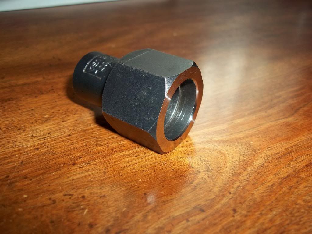

    Here's a couple photos of some of the parts I'd recently made for Neil.
    Old stock ones next to the new stainless steel:
    A bit closer:
    Finishing touches on the heads, the original ones were done via mass production cold header operation so I couldn't exactly duplicate, but came really close. He likes the little chamfer around the hex better than rounded-off look of the stock ones.
    Close-up of an M14x1.5 6H thread, done with one turn of pullout so there would be no relief groove as a stress riser.
    Bunch of SS washers.
    A spacer for one of the axles:
    Recently modified one of his OE wheels to accept a different type of (right angle) Schraeder valve:
    I'm just need cost of materials and perishable tooling covered for small personal projects. If trying to develop a commercial product, we'd have to talk.

    Nice looking products you got there.

    That is some EXCELLENT work. Right now my goals are strictly personal, but that's not to say I don't have ideas that could sell... I'll put some notes together and PM you.

    Wow those look awesome. 316 is a pain in the ass to work with.

    I've worked with 316SS for over 30 years so I've got a pretty good handle on it. What you see isn't the hardest of the work. I also make some larger diameter front axles (putting a GSX-R front end on an RZ350) and the challenge of making 12mm and 20mm holes through up to 12" of length was more of an issue. I my days of working in a shop it was a no-brainer with high-pressure coolant-thru spindles and solid carbide coolant fed drills up to 30xD deep. In my home shop I'm limited to flood coolant and extra-length parabolic flute HSS-Co drills and lots of peck cycle.
    I got it done though, trying to find photos of them.
